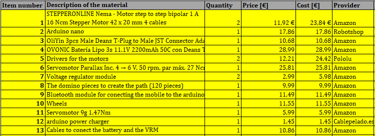

1 Motor step to step bipolar 1 A 16 Ncm Stepper Motor 42 x 20 mm 4 cables
2 Arduino nano
3 OliYin 3pcs Male Deans T-Plug to Male JST Connector Adapter 3.93inch Heavy Duty 20awg Wire(Pack of 3)
4 OVONIC Batería Lipo 3s 11.1V 2200mAh 50C con Deans T Conector para RC Evader Bx Car RC Truck RC Truggy RC Airplane UAV Drone FPV
5 Drivers for the motors
6 Servomotor Parallax Inc, 4 → 6 V, 50 rpm, par máx. 27 Ncm
7 Voltage regulator module

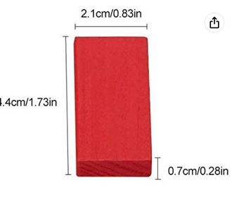

8 The domino pieces to create the path (120 pieces)
9 Bluetooth module for conecting the mobile to the arduino
10 Wheels
11 Servomotor 9g 1,47Nm
12 arduino power charger
13 Cables to conect the battery and the VRM

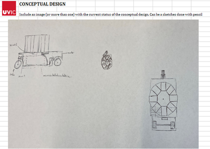

Step 1: Define Conceptual Design
Here we decide how the robot's gonna work, the mechanism to place the pieces, the supplies to build it.

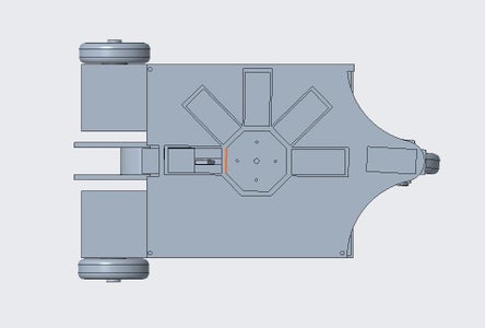

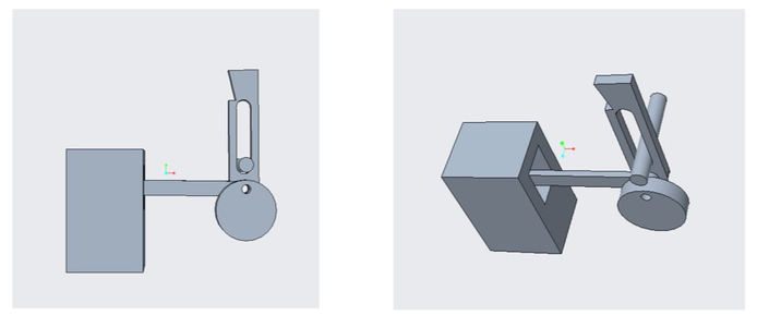

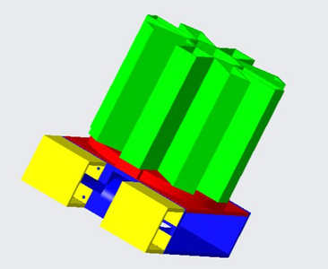

Step 4: Mechanical Part
Here we will post pictures of the design. We used PTC Creo as the major program to design a 3D model of our prototype.
