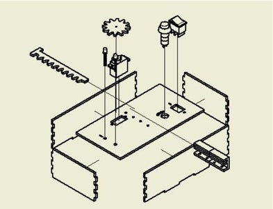

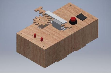

5. Electronics Box
The electronics box is the core of the robot. It’s placed at the front on top of the support. It includes the electronic components, and for the ones that have to be outside such as the batteries or the power bank, they are directly linked to the electronic box.
To make it, you need the laser cutter again for each side of the box as well as the top cover. Cut both “electronic box side“ and “electronic box front“, which constitutes the 4 sides, twice and the “electronic box top“ file once since it’s the cover. If you use a different button and/or switch, the dimensions of the holes for those may need to be changed. For the cover, the indication markings (START, I, O, etc.) can be engraved or cut, whichever you prefer. Note that you don’t need a bottom because it’ll be directly put on the support. To assemble the walls of the box, finger joints are used so you need to join two sides together, a rubber hammer could help here as well.
The cover will not be assembled the same way with the other parts because it has to be removable to access the electronic components inside. Small L-brackets called "slide box holder", have to be 3D printed four times and bolted to each corner of the cover part and then bolted to the assembled front and back of the box.
While being laser cut, some holes have to be made in the parts of the box. That is, for allowing a few wires to come out for the power supplies. As previously mentioned, in the support there are some holes too for the sensors and the motors wires to come out of the electronic box to the components.
On the top cover outside, Positions for the switch, the button and the LEDs are marked and cut. The servo motor and the rack of the pushing system are also placed on it in such a way that they're in front of the storage.
To add all the necessary components to the top, the LEDs have to be glued and the switch and button can be secured by the nuts they come with. To connect the pushing mechanism, start by bolting down the guides for the rack to the four holes that are in a line and bolt the opposite guide on top of the one closest to the button. Use nuts to secure them all in place. The servo can be inserted into the rectangular hole and then bolted down using the circular ones next to it. Next, insert the rack into the guides and then screw the gear onto the servo, either with one screw directly into the middle of it or two screws that bore into a symmetrical arm that comes with it. The second option is less likely to come loose.
Once the top is filled with the necessary components, it can be bolted onto the side of the box with the L-brackets. You can test the push system seperately to make sure it works by making an Arduino program that moves the servo from 0 to 180 degrees. If there is a lot of play on the rack, a small wall on the right wall of the storage might have to be added so it doesn't get stuck.
