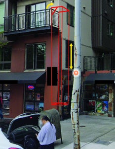

I started out with a sketch over a picture of the balcony from Google Maps.
Then I went through and defined the requirements for the final build. These included ease-of-use elements like a crank to raise/lower the platform and that constraint that the final design is able to be removed/reattached easily.
