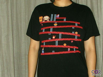

Step 1: The Original Tshirt and Skirt.
The original tshirt bought from Target a while back. I always felt uncomfortable about wearing it because it's such a boring top, with exception to it being a Donkey Kong tshirt of course. It's not available anymore sadly, cannot find it online.

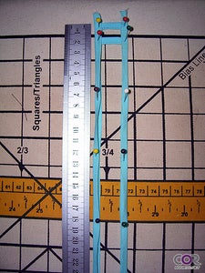

Kraft paper or mail wrapping paper for patternmaking

Painter's tape (for bright marking)

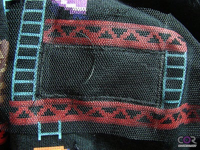

Tested and practiced on a crappy tshirt before moving on to the Donkey Kong tshirt because it's irreplaceable. So important to do this!
The dancewear mesh fabric for the window actually came from a trim because the fabric by the yard couldn't be found in retail fabric stores at the time. I traveled to 4 stores: 2 JoAnns, Vogue in Evanston, and a closed Hancock which gave me a heart attack. I remembered Hancock Fabrics would have it because I used to buy from there (and used to work there a long time ago.)
The fabric was wide enough for me to use on the window and I dismantled it form the trim. Eventually I found the mesh net fabric by the yard but it didn't seem as dark as the one I found on the trim.

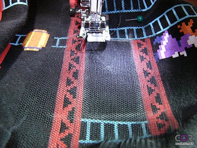

Made a sandwich of mesh net fabric, tshirt, and tear away stabilizer.
The stabilizer will help feed the knit fabric through the sewing machine while providing support for the satin stitches. It will also probably strengthen the window too.
Made heavy marks on shirt and mesh with white tailors chalk.
Used a zig zag stitch with small compact width and length to produce a neat compact (but not bulky) satin stitch.
Sewed the rectangle shape that will become the window.

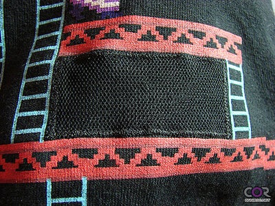

Next I trimmed off the excess mesh net outside of the window and satin stitches. Normally applique scissors are used for close trimming but holding the scissors at an angle will suffice.
Tore off the tear away stabilizer. Not worried about it being white against black fabric because it is in the inside of the shirt anyway.
To make sure I do not accidentally cut the mesh net I used a pin to lift up the tshirt fabric off and away from the mesh and snipped it a little.
With this little hole, I cut a X towards to corners of the rectangle. Trimmed off the excess the tshirt fabric close to the stitches but being careful not to cut the satin stitches.
At first I wanted to create 3 windows and using only the straight lines of the graphic to produce them.
It was suggested that I only make 1 window. Later changed my mind and made 2 windows instead. I regretted doing this and should have left it at one. But that's okay, it's barely noticeable anyway.

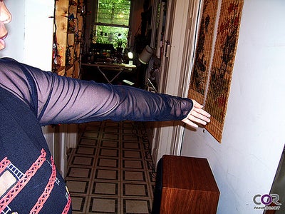

Placed the old tshirt sleeve on top of a tshirt (that fits me) that has raglan sleeves.
Put kraft paper at the bottom and started tracing and blending both shapes.
Made it longer to extend past my wrist as well.
Kept checking to make sure everything fits, at first it didn't but I fixed it and finally had a paper pattern to cut the hard-to-get mesh net fabric from. Placed the paper pattern on the fold of the fabric, crosswise grain so that the selvage can act as a finished edging on the wrist.
Could have made a slimmer sleeve to begin with but my concern was the new raglan sleeve fitting in the original tshirt which still has its curved ribbed neckline.

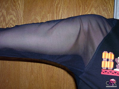

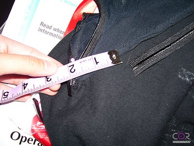

To fix the baggy sleeve I used painter's tape to mark off new seam line, sewed it, tried it on,
and discarded the excess.
I like using painter's tape or any cheap, bright tape to hold stuff down temporarily or mark items down, it's also reusable. Since I don't have a tailor or seamstress to help me pin and make chalk marks, the tape makes it easier.
Used the discarded excess raglan sleeve as a pattern to cut off and sew the other sleeve.
I dislike raw edges so I used black foldover elastic to make a nice seam in the mesh knit fabric.
My serger is out of commission so I started using this notion and it's wonderful because all you do is encase the raw edges with it, fold it, and sew. Like bias tape, but stretchy. This elastic has a center that makes it easy to fold so it's not like regular elastic. It's also very hard to find in retail stores. Some clothes use this notion, like tank tops and underwear.
Hence it was frustrating when I was short by 2 inches to finishing the 2nd sleeve raw edge.
Found another substitute that's softer and bulkier but not the same exact thing but it will have to do for now.
