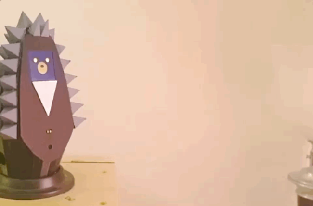

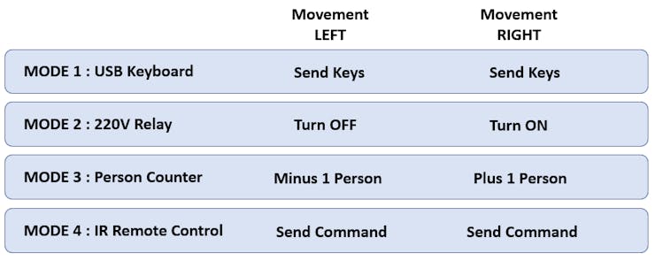

By default GH detects three movements: Left, Right and Up. The left and right movements allow you to send commands depending on the actual mode:
To switch from one mode to another, simply leave your hand within 15cm of the sensors for 3 seconds. You don't have to use all the mode, just comment the modes you are not using on the top of Arduino Program.

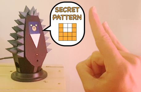

In addition to the different modes, you can always use Pattern Recognition with the upward movement the upward. GH will detect on a 4x4 pixel grid the shape of the object in front of it. The Arduino program allows to easily add Pattern and match it to an action.
To add security, a Pattern and a Keyboard Password can be saved in the secure element ATECC508. With the right configuration, it will be impossible to recover the Password unless the Pattern match. See the ATECC508 section for more informations. (This part isn't finished yet)

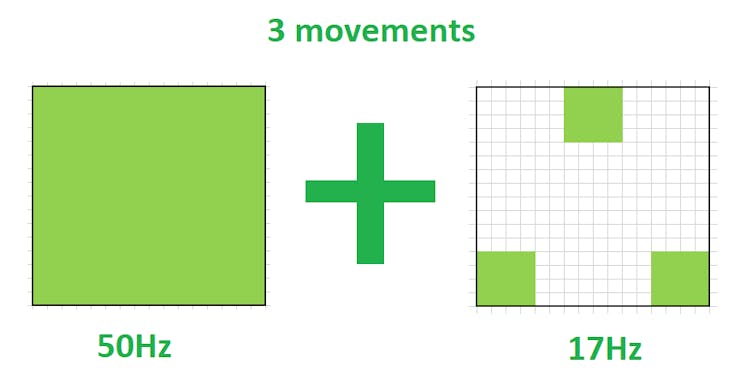

This is because VL53L1X not only detects proximity, it can also target this information to a detection field. The SPADs thus form a 16x16 pixel grid like this :
There is however some restrictions, the detection area cannot be less than 4x4 pixel. By using a reading of each area without overlapping, one can therefore have a reading of 4 pixels by 4 pixels, i.e. 16 detection zones. The other restriction is speed. Using 16 pixels at 50Hz per reading is barely 3Hz for a full reading. You can find an Arduino/Processing Example on Git repo.
The mode reading Pattern read the 16 ROI and print everything on the LCD.
After several tests, the configuration that seems optimal to detect 3 movements (left, right, up) is with 3 ROI. As soon as a SPAD detects an activity, it trigger a detection_flag to 1. The last SPAD to detect something while this detection_flag is active considers it as a movement in this direction.
In theory we could also do a DOWN motion detection with this pattern. But my algorithms are not yet robust enough and the refresh rate in relation to the motion doesn't make it easier.
To further optimise, I improved the detection by reading all the SPAD at 50Hz. When it trigger something, then I set a detection_flag to 1 and then I start reading my 3 ROI at 17Hz.

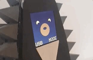

To start with, I imagined how to represent my hedgehog with simple shapes that I could generate with the Arduino GFX library. Here, my screen displays the eyes (2 circles) and the nose (1 circle + 3 mini circles) of my hedgehog. I can thus simply use GFX without having to load an image in memory. In addition, I can draw the circles without reloading the whole screen, which allows me to gain a lot of speed.
In order to validate the shapes and movements, I started by a simulation on Keynote
****GIF Missing keynote expression
On the LCD, to implement a movement simply, I redraw the previous shape in black and then I redraw it with color to its new position.

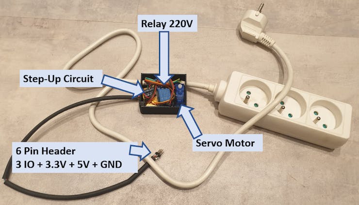

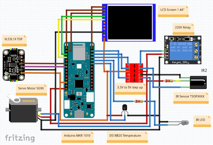

Step 9: Relay 220V / Servo Motor and Temperature Sensor
For this part, I have created a small outer box allowing me to isolate these components from the main system. Remember that the Servo and Relay work better at 5V, that's the reason I used a Step-Up board to convert my signals voltage. The 3D is on the GIT repository.

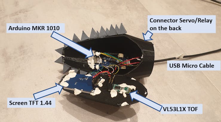

Step 12: Build the Device

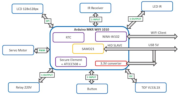

Block diagram
Hardware
Software

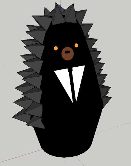

3D Design

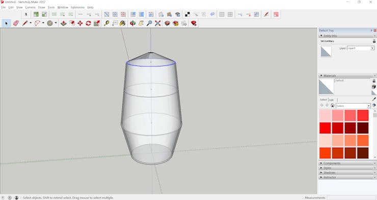

I admit I've already drawn many 3D on Sketchup, but I really didn't know how to do this one... After some research, I went on a tube shape in which I drew circles. By deforming these circles I was able to arrive on the shape I was looking for. To adjust a dimension based on the center of the shape, simply hold down the ctrl key.
For the front, I just placed a flat face using the "Intersect Faces" option. Here is the result :
0
And here is the rendering on Sketchup with a little color and a lot more spines

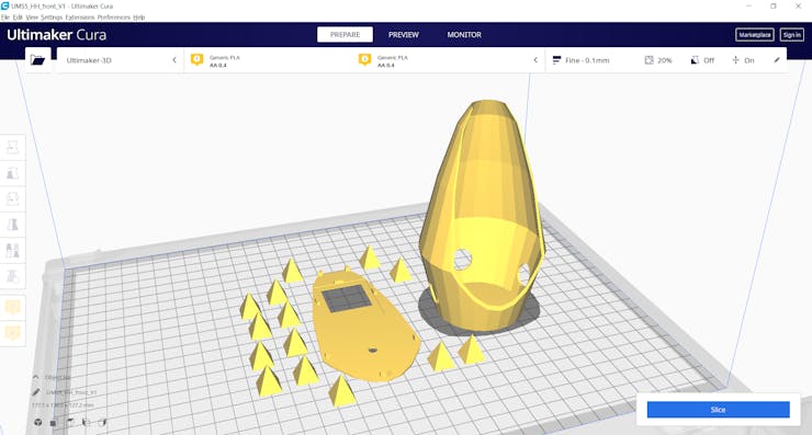

And ready to print with CURA (some spines are missing...)
