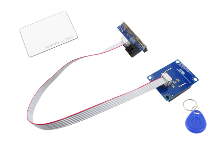

Take the ControlEverything Raspberry Pi I2C Adapter and line up with the P1 pin on the adapter facing the Pin 1 on the Raspberry Pi GPIO as shown in Fig.1
The RFID module uses the Raspberry’s UART connections (GPIO 14, 15, +5v, Gnd). If you use the Grove RFID, set it to use the UART. This is a Serial 9600 baud connection between the Raspi and the RFID module.
Next plug the included grey cable into the Raspberry Pi Adapter. (Fig.2)Fig
Adapter 6 pin port, making sure the red wire is facing the white indicator line on the adapter board.
Then plug the grey cable into the RFID module, again with the red wire facing the white indicator line.

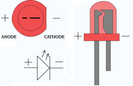

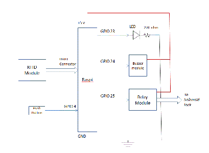

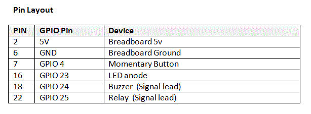

Use the diagrams and photos to assist in wiring the LED, Buzzer, Relay and button. Note that the Grove wiring will be slightly different as it uses +5v, GND and Signal leads, instead of just two wires.
If you are using the ConnectEverything I2C Relay module, you just plug it into the Pi Adapter I2C port.
For the other devices (LED, Buzzer, Switch and relay) connect using the diagram and pins shown in the figures above.
Note for Grove wiring, you will need to use Grove universal connectors and solder to a board as they no longer carry a Raspberry Pi shield.
The GPIO pins for Raspberry Zero, B+, 2 and 3 are identical, so the same diagram will work for either.

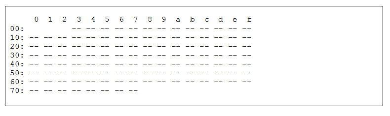

$ sudo i2cdetect -y 1
If you have no I2C devices plugged in, you will see the above Fig.1
Once you plug in a device and rerun the command, you should see it show up in the list. (Probably need to reboot, if you didn’t power down before plugging it in.)
Note that the EM18 RFID module isn’t an I2C device, so doesn’t show up.
The ControlEverything 1 or 2 channel relay module is I2C, so should show up in the I2C devices list as 0X41.
