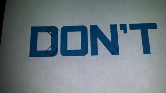

*You'll need a template with the words DON'T PANIC written on it in simple, block lettering. You can either use a printed block style font or draw it yourself. Eliminate as many angled lines on the letters as possible (though this in unavoidable for the letters "N" and "D" which will be dealt with in a subsequent step).
Don't necessarily use the template I sewed with as an example of the right letter shape. The black lettering included in this step, which I designed after I made the towel shown here, is a good example of the kind of template you'll want. Either make your own or use mine.
Scale the letters to fit the area you want to embroider. If possible, use ink in a color similar to that of your thread.

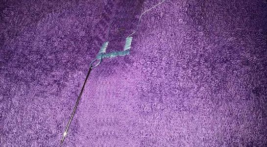

For each thread tail on the top of the embroidery, I load it into a regular sewing needle and pull the thread to the back of the towel. There is a second thread on the back that corresponds with each of these.
Once the top thread is pulled back, tie it in a double knot with its companion thread tail. Then thread the pair through the eye of the needle and pull them through a section of the letter stitching on the back. This holds down those ends, preventing the knot from unraveling.
Snip off the ends. You'll need to do this quite a few times but the results give a neat finish.

The "N" and the "D" (which I elected, after I started, to use angled corners on to prevent it from looking like an "O") have some angled lines. The "A" does as well but it is possible to use a block "A" that does not.
The key here is to extend the lines of those angled parts. The lines will show you where to start and begin the angled sections so that, when the other stitches are added, the letters are completely filled in. Draw on the extended lines, as shown. Then stitch those angled sections FIRST. Finish the letters as usual.
