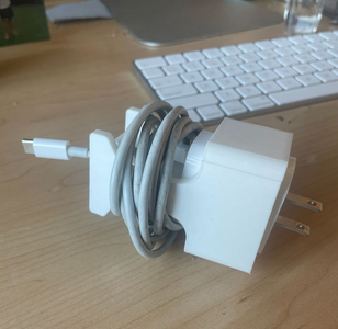

Now that you have a complete prototype, we will introduce you to CAD (Computer Aided Design) to help further refine your doodad. CAD allows us to visualize our design in 3D, and then directly convert those models into real parts using laser cutting or 3D printing.
Here’s an example of my CAD design. Making the prototype really helped me figure out how I wanted to design my part in the computer and saved me a lot of time. I’ve been using CAD for years, so it’s okay if your model isn’t as complicated as mine.

Once you have your CAD program open, watched a few CAD tutorials, and familiarized yourself with the software, you can start designing your doodad! Unless you've had previous experience with CAD, I recommend that you only use the basic functions (like extrude and revolve) to make a rough model of your prototype. It's okay if your first model isn't perfect; expect to refine and redo them as you go.

When you have your completed doodad in your hand, test it out! What works well? What doesn't? Expect to go back to CAD to edit your design. Feel free to even take an entirely new approach. If you are in a classroom, present your work to your classmates. Explain what your doodad does and make sure to show off your cardboard prototypes and any older 3D printed or laser cut versions that you made. Talk about your design process and what you liked and didn’t like about each version of the doodad that you made. Don’t worry if your doodad isn’t 100% functional when you’re presenting. Believe it or not, it can take even experienced designers days to make something as simple as a charging cord organizer. Congrats on finishing your first design activity!
