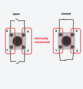

For last part we have to connect the switches/buttons. By default the pins in one row will be connected internally, when pressed, all pins will be connected. For this schematic the buttons are wired in a pull down configuration. If we refer to the wiring numbers of the second picture:
  • Pin 3 Button <->5V on Arduino
  • Pin 2 of Button <-> digital Pin on Arduino
  • Pin 2 of Button <-> 10k Ohms resistor <-> GND
When the switch is open, the resistor will pull the digital pin to GND, meaning a LOW state will be visible for the Arduino. Once we push the button, pin 2 and 3 will be connected. With that we will have the 5V that on the digital pin connected to pin 2 and as such the Arduino will see the digital pin as HIGH state.

To simpify the assembly, I made three changes as opposed to the Tinkercad project:
  1. Arduino nano will be used instead of Arduino Uno, resulting in slightly different pinout for the lcd only! (SDA=A4, SCL=A5 ont the Arduino nano)
  2. Buttons will be used in a pull up instead of pull down configuration, resulting in inverted logic
  3. In pull up configuration, the digital pin is connected to 5V via an internal pull up resistor, meaning in the default button opened state, the digital pin will be at 5V
  4. When the button is pressed, the digital pin will be connected to GND over the bridged button connection and thus will be at a LOW state
  5. Built in internal pull up resistors are used, making the external 10k Ohms resistors redudant
