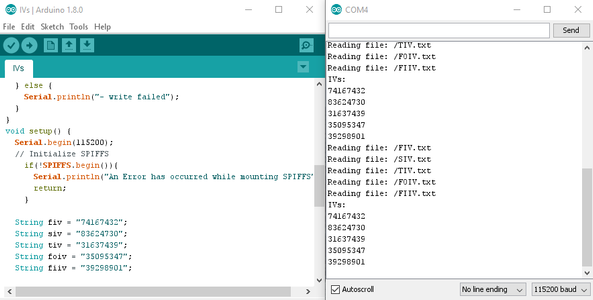

Step 6: Generate the IVs
There are lots of methods to generate Initialization Vectors. I've decided to throw 20-sided dice to do this. Every time I was getting a number with two digits, I was writing down the last digit. Eventually, I've generated these five 8-digit numbers:
74167432
83624730
31637439
35095347
39298901
The maximum value of IV is 99999999. If you've generated something more than 99000000, I would advise you to either change the first digit or generate the new IV.
Step 7: Upload the IVs Into Both ESPs
Open the sketch called IVs and replace the IVs in this sketch with the ones you've generated.
After that, upload the modified sketch into both ESPs.
If you did everything right, you should see the IVs in the Serial Monitor.

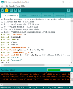

Step 10: Flash the Transmitter Board
Upload the firmware from the folder \Doomsday_Messenger-main\ESP_transmitter into the transmitter board.

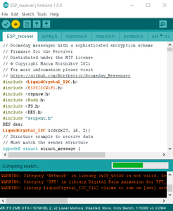

Upload the firmware from the folder \Doomsday_Messenger-main\ESP_receiver into the receiver board.

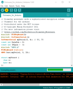

Step 12: Flash the Arduino
Upload the firmware from the folder \Doomsday_Messenger-main\Firmware_for_Arduino into the transmitter board.

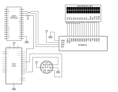

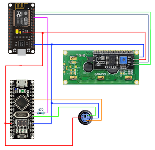

Step 13: Build the Transmitter
You can find a Schematic diagram for the transmitter in step 14.
You can find a Circuit diagram for the transmitter in step 15.
Step 14: Schematic Diagram
Step 15: Circuit Diagram

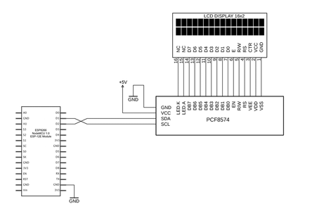

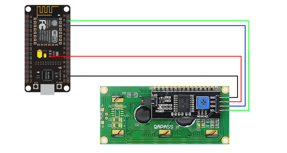

Step 16: Build the Receiver
You can find a Schematic diagram for the receiver in step 17.
You can find a Circuit diagram for the receiver in step 18.
You might've noticed a 3.5 mm jack socket. It's a remnant from one of the previous projects.
Step 17: Schematic Diagram
Step 18: Circuit Diagram
Step 19: Test the Device
Power up the receiver first, then power up the transmitter.
You should see the inscription "Delivery success" in the display connected to the transmitter and the inscription "IVs adjusted!" in the display connected to the receiver. Type the message on the keyboard, press "Backspace" to remove the last character, press "Enter" to send the message.
The blue display (on the right) is connected to the transmitter, the yellow display (on the left) is connected to the receiver.
Due to the poorly implemented PS/2 keyboard-to-ESP interface, I would recommend you to type no faster than one symbol per second.
Important note: The receiver only accepts the IV5 which is more than the stored IV5 but no more than the stored IV5 + 50. The transmitter increases IVs by two each time it is powered up. Don't turn the transmitter on without the receiver more than 24 times in a row.
