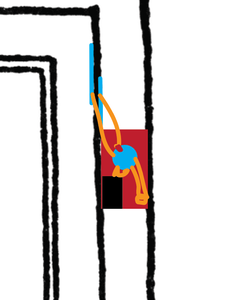

Here is the basic blueprint I used for my alarm. The red square is the box that your circuit playground and battery will sit in, attached to the door frame on the same side as the hinges. This is where you will have to measure your door to make sure your box fits properly. The two blue lines in the top right are the two copper plates in between the door and the frame. Once again, you will have to measure your own door to make yours fit perfectly - you may need to add more duct tape to make sure the plates are touching when the door is closed. The alarm only functions if the plates touch, since they are what completes the circuit. The black box is the battery, and the other orange lines connect to the LED which is also housed inside the box.
