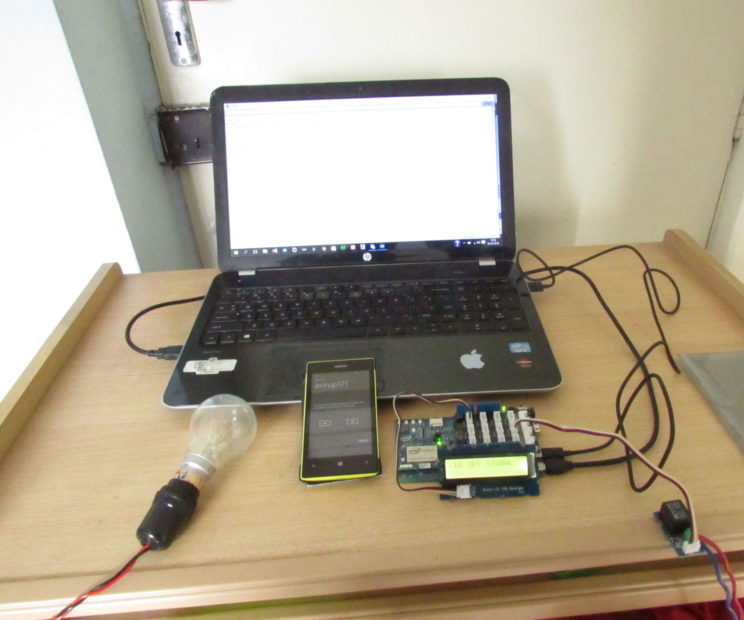

Step 3: Circuitry and Hardware
The circuit consists of the following components
1: Intel Edison
2: Seedstudio grove servo
3: Seedstudio grove base shield
4: A LED
Connect the LED to PIN 13. Attach the base shield and connect the servo to digital pin 3. Attach the sound card and then you are done.
