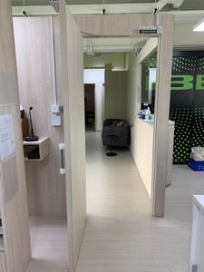

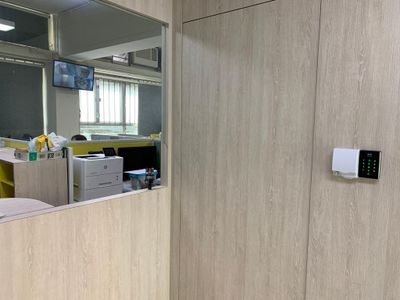

Last year, we had the stem workshops in form 1 to form 3. In the stem workshops, s1 to s3 students learnt how to use the microbit for measuring hear rate, recognize the faces and sending the emails by IFTTT. In the summer, our general office was renovated. New walls and new doors were installed in our general office. However, when we opened the door of our general office, the door sometimes hit someone behind the door. It was not safe. In addition, we could not install the glass on the door because of the decreasing security level. What could we do to improve this not ideal situation? Our stem team tried to solve this problem by using the skills learnt in the stem workshops. Our preliminary design, we would consider the situation of the both safety level and the security level in our general office. In order to increase the safety and the security, we implemented the smart access system. The stem teacher used this example as an real application for students learning the microbit. They all found the interest about coding and electronic circuit which kept them engaged in learning using the micro:bit!

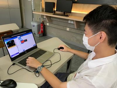

Step 1: Hardware Connection With Blockcode Program
First, we connected one distance sensor, one microbit with one Driver Expansion Board and one NeoPixel Ring - 24 x 5050 RGB LED by using dupont wires as the circuit ( using Tinkercad's Circuit simulator to draw) . Second, we wrote the program to test the circuit. Finally, we connected two distance sensors (Two distance sensors circuit) by using different pins of microbit and rewrote the blockcode program.
Step 2: Two Distance Sensors With LED Ring Controlled by Microbit.

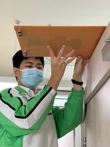

P0, P1, P2, P8, 4 pins from microbit expansion board were connected to the trig pins and the echo pins of two distance sensors.
P12 pin from microbit expansion board was connected to the NeoPixel Ring - 24 x 5050 RGB LED.
Step 3: How Did the Blockcode Program With One or Two Ultrasonic Sensors Work?

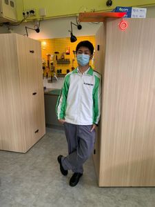

Our idea was innovative. If the person was behind the door, the smart access system would give the warning signal. If the ultrasonic distance sensor detected the hand closer enough, it would turn NeoPixel Ring - 24 x 5050 RGB LED on and showed the led X pattern on the microbit .
Step 4: The Principle of the Safety Device
If any person was behind the door, two ultrasonic sensors installed on the plastic board which increased the sensitivity and the area of detecting coverage, would detect the person. So, the 'cross' pattern was displayed and the LED ring would be on. Otherwise, the 'tick' pattern was displayed and the LED ring would be off.

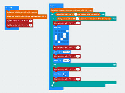

Step 5: The Access System With AI Lens

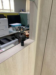

We used the huskylens to recognise the staff who could have the access right to the general office. By using the microbit with the Driver Expansion Board to control the electric solenoid Lock, if the huskylens recognised the staff, the microbit with the Driver Expansion Board would send the signal to the relay to open the electric solenoid Lock by using pin 8. In addition, the microbit could know the status of the electric solenoid Lock (lock or unlock) by detecting pin 0 which was high or low (optional but not necessary).
Step 6: Huskylens With Microbit
The Huskylens learnt the images by the face recognition function, embedded in the huskylens. Four possible images that the Huskylens could learn. By writing the block codes, the AI system could recognise the face which could give the 'tick' symbol or the 'cross' symbol on the LED of the Microbit. In addition, by using the relay, converting 5 V to 12 V signal, the electric solenoid lock could be controlled by AI system.

Step 9: LED Ring on or Off According to the Obstacle Under the Safety Device.
Step 10: The Smart Access System ( Higher Safety and Higher Security)
The Huskylens was installed with the pan and tilt system which made by two servos controlled by the microbit. This design could be applied to change the orientation of the Huskylens to adapt the real situation. At the same time, the microbit with huskylens controlled the door in the general office. The LED ring as the alarm light, were installed on the wall. When the people was behind the door, the alarm light would be on. The students saw these applications. They said that the smart access system was amazing.
