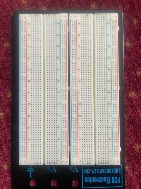

So basically here what I have made is a program that will monitor any opening in your house like door, window or garage door . The led's in this project are just for indicating that there was an output either open or closed, not required unless you want to show it on a board. I also used a push button on my circuit to simulate door contacts changing state, you could also replace the led with a piezo buzzer. You could also output this to a LCD display and an annunciator .
If the file that shows connection don't display then ,
1)leds are connected to pin 8 and 9 respectively with a 220 ohm resistor as ballast
2) Door contact is pin 12 and Gnd with a 100K resistor as ballast
3) I used a momentary push button to simulate door state so at the 100k resistor and pin12 connection is one
side of a dry contact and the other side would go to Gnd
If you are using this to monitor a garage door and not using dry contacts I strongly recommend the use of a relay or an opto coupler, Arduino has a 20 mill amp max so you need to protect your board.
