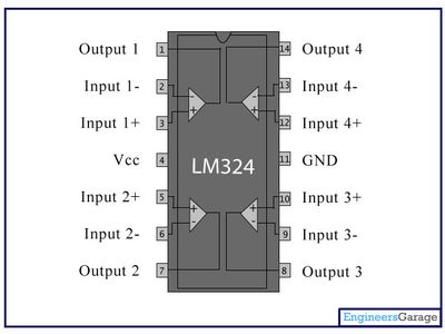

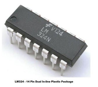

1. IC LM324N (1 pc)

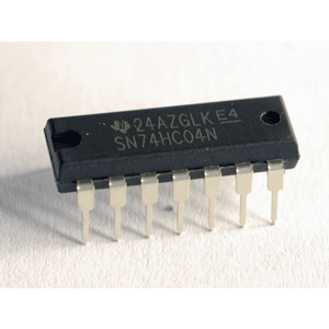

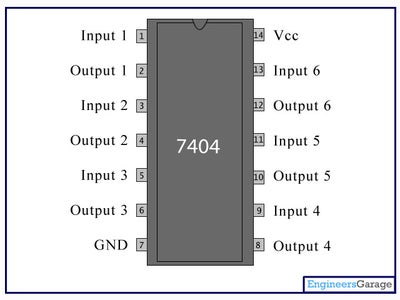

2. IC 7404 (1 pc)

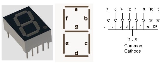

5. 7 segment display(Common Cathode) (2 pc)

6.Pin 6, pin7 and Pin9 to pin 13 - These are 7 decoded output from a to g used to illuminates the corresponding segment of 7 segment display to display the digit from 0 to 9.

LM 324 N is a quad OP-AMP ic. The LDR acts as a receiver, and the LED acts a transmitter. The 10Kohm POT is used for the adjustment of the sensibility of the sensor. The output of the sensor id fed into the circuit of CD4026/332 and 7 segment display. here we have used 2 7 segment display which can count from 0-99. When there is an interuption in the LED-LDR path the buzzer is on. In place of buzzer you can use LED also. As soon as there is an interuption the counter counts +1 which is visible on the 7 segment display .IC CD4026/33 is 7 segment decoder ic. Its pin configuration and details has already been discussed.The 100Kohm resistor is used to reset the counter.The 270 ohm resistor is used to control the light itensity of the 7 segment display. Instead of LED-LDR Sensor, one can go for IR Sensors or LASER or Ultrasonic sensor.
