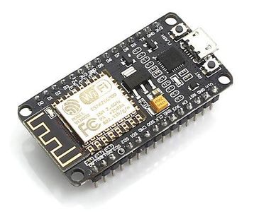

I had this doorbell for a while, but I didn't find it to be very useful. I almost always listen to music or do something to make enough noise to cover the intercom alarm. I had laying around an NodeMCU with ESP8266, so I wanted to use it to make it push notifications to my phone every time someone pressed the button outside my home.

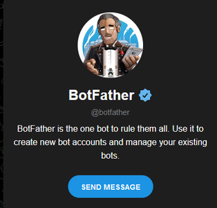

Step 1: Telegram Setup
First off, download the Telegram App and make an account for it. The Telegram platform has easily configuring bots to make various things, is free to use, and are relatively fast to respond.
After creating an account, search for "Botfather". It's the interface from which you'll make your new bot. Follow his instructions and customize it as you want.

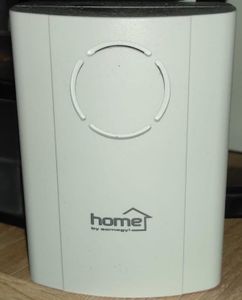

The easy way is to find a wireless doorbell, so you can place it in convenient places, like your desk.
After finding it, you must take it apart and get to the speaker.
The circuit is simple, wire A0 from the NodeMCU to speaker red/+ sign lead, ground to battery- sign or speaker- sign and battery+ to 3.3V from NodeMCU (my doorbell needs 2 batteries, it's almost a spot on voltage).
Engineer a case for the whole system, or do as I did, and tape over the closing hatch of the batteries, encapsulating the NodeMCU from within. I left the MicroUSB free, for programming and powering up the system afterwards.
