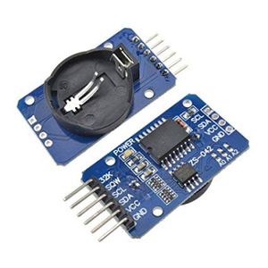

  • RTC Module (DS3231)

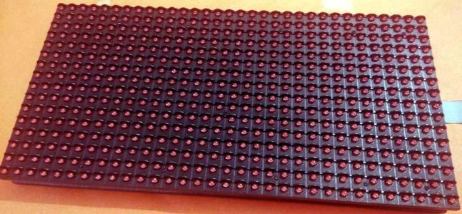

  • P10 Dot-matrix Display

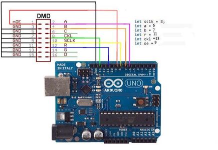

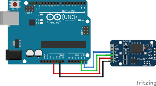

Step 1: Connections
*Arduino -> RTC MODULE*
A4-> SDA
A5-> SCL
VCC -> 5V
GND -> GND
*Arduino -> P10 DMD*
D8-> SCK
D6-> A
D7-> B
D11 -> R
D13-> CLK
D9-> OE

DMD
  • 32 x 16 high brightness Red LEDs (512 LEDs total) with 10mm pitch
  • Supports 5V operation
  • Viewable over 12 meters away
  • Tough plastic frame
  • Onboard Controller IC
  • Arduino compatible library, graphics functions
RTC
  • counts seconds, minutes, hours, and year
  • Accuracy: +2ppm to -2ppm for 0ºC to +40ºC, +3.5ppm to -3.5ppm for -40ºC to +85ºC
  • Digital temperature sensor with a ±3ºC accuracy
  • Two Time-of-day alarmsProgrammable square wave output
  • Register for Aging trim400Khz I2C interface
  • Low power consumption
  • Automatic power failure battery switch circuitry
  • CR2032 battery backup with two to three-year life
