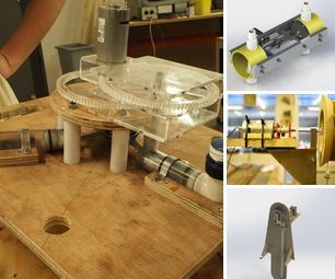

We are Team Orca, a group of four second year Product Design Engineers, from Glasgow School of Art and Glasgow University. We got given the task of building a water pump to lift five litres of water through a height of approximately 600mm. The competition was judged on efficiency and all teams were supplied with a 24V DC motor. Out of 5 teams we came second!

Gearbox and scotch yoke mechanism , you can make this yourself but we used one from a cheap jigsaw

Step 8: Adapting the Scotch Yoke
A scotch yoke and gear mechanism was taken from a jigsaw. It needed to be adapted in order to drive the diaphragms and be driven by the motor. These were laser welded (we couldn't weld normally as the ventilation wasn't working there at the time) onto the scotch yoke as shown above.
Step 9: Putting It All Together
Create two aluminium guides for the driving rod as shown. Assemble the two pumps by putting bolts in the holes that have been tapped through all the parts (sealing ring on top, then diaphragm, chamber and last pump body). Use pipe cement to assemble the manifold to the desired length and shape. Lastly create a frame of mdf to keep it all together.
Step 10: Sealing the Pump
Prior to the final stage of sealing, the pump was tested several times and it was noted how each time vast volumes of water were lost due to leakage at the sides and centre of the diaphragm (where the driving rod was attached). By sealing well, it creates a vacuum and ensures that as much water as possible is conserved. It also enables the pump to prime better. Therefore this is a very important stage, which should include sealing between the sealing ring, rubber, screws and chamber. As well as between the driving rod, washers and rubber at the centre of the diaphragm.
We could probably have done with quite a bit less silicon for the looks, but we were running out of time and needed the pump working optimally.
