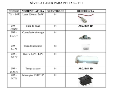

So that the construction of such equipment can occur; I indexed the photos of the components in Portuguese

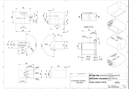

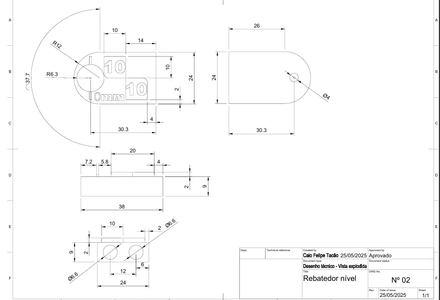

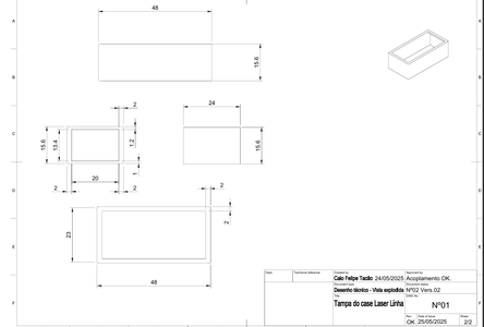

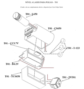

Of course, the first step towards building our pulley aligner is in its original format, I will make the case files available to you in STL for printing on a 3D printer, I will also make a small exploded view of the aligner available, so that you can see from now on where each one fits.

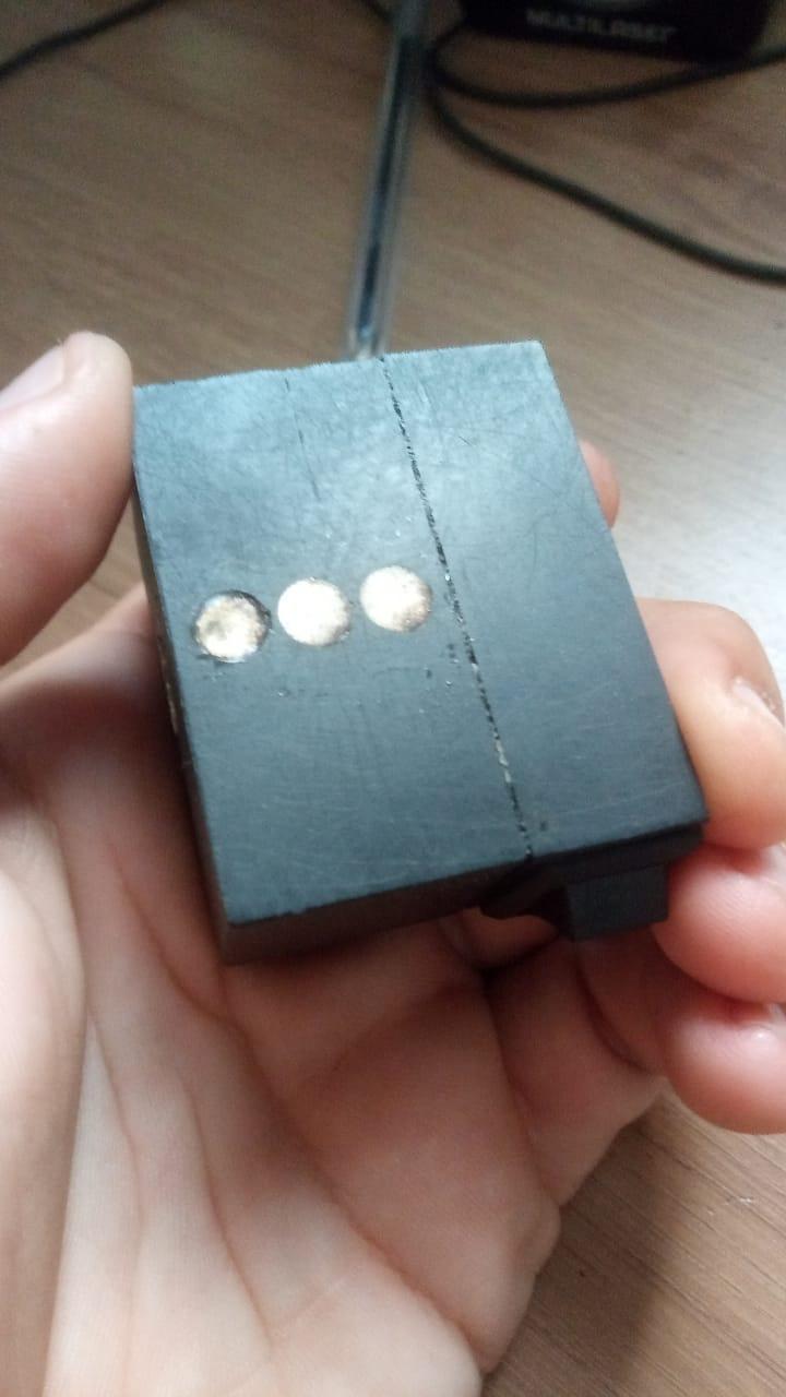

before actually "sticking" the magnets to the back of the aligner (laser head) with super glue, it will be necessary to sand this side; What I tell you is... first assemble the entire laser scope and then, after everything is fixed, sand with infinite movements (or in figure eights) to better roughen the printing lines; You can see the result in the photo I made available, clearly and extremely smooth and uniform... then... you can glue the 3 magnets into the holes very carefully and carefully!!!
