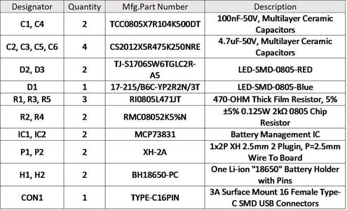

Figure 10 shows the bill of materials for this project.
