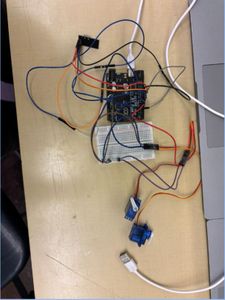

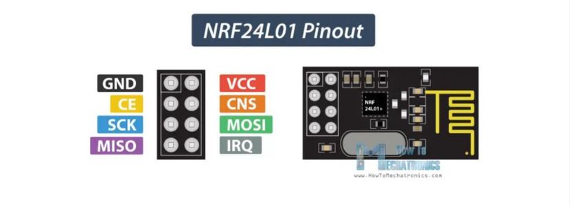

Step 1: Wire the System (Transmitter and Receiver)
Both the transmitter and the receiver RF24 module are wired the same which makes it nice and easy. An important part of the wiring process is to make sure the bluetooth modules are connected to the 3.3 volt power source instead of the 5 volt. The wiring pins that we used for the modules were:
  1. CE pin to pin 9
  2. CSN pin to pin 8
  3. GND to GND and VCC to 3.3V
  4. MOSI pin to pin 11
  5. MISO pin to pin 12
  6. SCK pin to pin 13

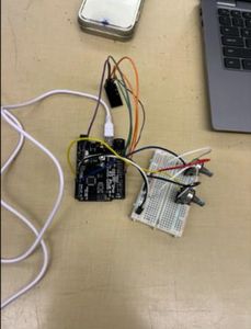

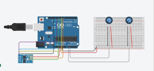

Step 2: Transmitter Arduino (with Potentiometers):
  1. Connect the first potentiometer to A0 and the second potentiometer to A1 on your Arduino.
  2. Connect the nRF24L01+ module to the Arduino:
  3. CE pin to pin 9
  4. CSN pin to pin 8
  5. GND to GND and VCC to 3.3V
  6. MOSI pin to pin 11
  7. MISO pin to pin 12
  8. SCK pin to pin 13

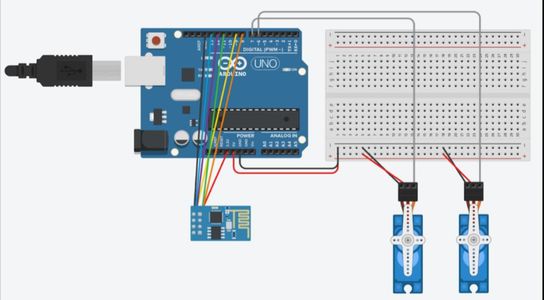

Receiver Arduino (with Servos):
  1. Connect the first servo to pin 7 on your Arduino.
  2. Connect the second servo to pin 6 on your Arduino.
  3. Connect the nRF24L01+ module to the Arduino (same wiring as the transmitter):
  4. CE pin to pin 9
  5. CSN pin to pin 8
  6. GND to GND and VCC to 3.3V.
