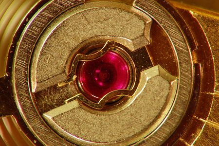

Below is a shot I took with this setup of 1 jewel in a pocket watch. Then another shot at full magnification. More sample shots on the last page.

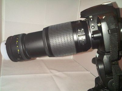

Remove the front lens cap from your prime lens. Now screw the macro coupler ring onto the front of the prime lens, the same way you would attach a screw type filter.
Now remove the front lens cap from your zoom lens. Take the prime lens with the macro coupler attached and turn it upside down, face to face, with the zoom lens. Screw the other side of the macro couple onto your zoom lens. The 2 lenses are now 1 as you see in the image below.

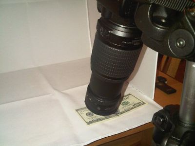

You'll see in the picture below that you have to be very close to your subject. Focusing can be a bit tricky till you get the hang of it. It's easiest if your camera/lens is pointing nearly straight down. Turn your focusing ring to about the center. Now you can slowly move your whole camera using adjustments on your tripod while looking through the viewfinder to see when it's in focus. When you're close stop, then fine tune your focus using the focusing ring. There's a very fine line between being in focus and not, you may have to try a couple times to get the hang of it.
Once you have the focus lined up you'll need to fire your shutter without creating any extra vibration on your camera. I use a wireless IR remote control which allows me to just point at the camera and press the button. If you don't have a remote use your self-timer. Set the timer to 10 seconds, press the shutter to start the timer and release the camera until the shutter closes.

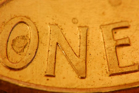

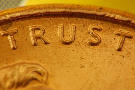

The pictures of the penny were taken without a flash. I had to take a 30 second exposure for there to be enough light in the photo.

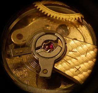

The next image is a balance wheel from a pocket watch. That is actually 1 of 17 jewels in the movement. Notice the black corners, that's because I zoomed back too wide and got the prime lens in the picture instead of shooting through it. In this case I like what it added to the photo.

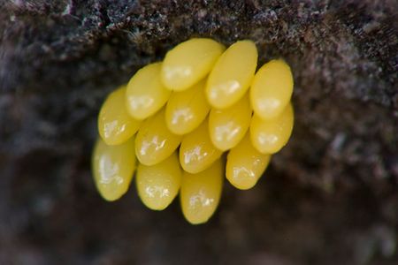

The final image is lady bug eggs that a found on the side of a tree in my yard.
