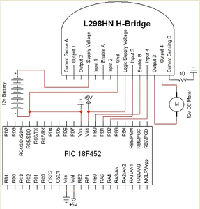

Step 4: Favorite Part Is to Connect L298N to 2 Motors
You can refer on L298N motor driver picture. There is the rest information how to connect the L298N to the motors and to Arduino. You can skip 10 OHM resistor which links the GRND with current sensor. Enable1 and Enable2 pins goes to A0 and A1 respectively. Pins 2, 4 ,6, 8 on Arduino plugs to motor A and motor B.
Step 5: L298N (motor Driver Chip)
Every single pin on L298N chip should be linked to motors to Arduino, to power supplying the chip, for power supplying the motors and 2 wires Enable1 and Enable2 to GRND. GRND linked to GRND Arduino board. No free pins should be left on L298N.
Step 6: L298N Chip
10OHM resistor is heating up, you can try to mount something greater than 10OHM, but the current will get too imitated and current sensing will not work. You will be not able to rotate the motors direct and opposite senses..
