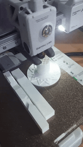

Step 10: Printing the Parts of My Model
Now to print it, we need to know how 3d printing works
From here it is all about printing the parts till we get what we like!
If you see 2 different printers here, that is because the first one went KaPuT! and had to buy a new one... Hence always research before buying a new one for reviews and quality. (I recommend the Bambu labs a1 mini for beginners).

Step 12: Printing
To Print simply insert the SD card in its slot and select the model from your printer and press/select 'print'.
