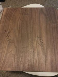

After coming up with a design in Google Sketchup, I purchased two fairly wide and long boards from my local woodworking retailer. Luckily I found two boards with interesting figure and similar color.
My first task was to lay the long boards down on my living room floor and look at them every possible way until they spoke to me and let me know which part should be each component of the box.
Next I grabbed some a pen and a tape measure and marked the front, back and sides of the box and made sure the grain would wrap around the box for a nice look.

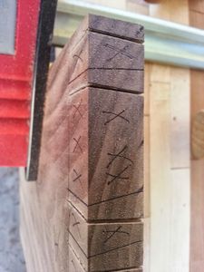

After the pieces are cut to final size and planed square, it was time to layout for the dovetails. I used a cutting gauge to mark the baseline of the dovetails on both boards before sawing.
Sketchup is handy to come up with interesting spacing of the dovetails. I combined the front and back pieces together and cut them both at the same time. I find a wider surface aids in sawing straight and it saves time. It is important to saw at a perfect 90° across the tails because any variation from 90° will show as a gap when it is put together.
After sawing to just above the baseline, I used a fret saw to remove the waste. Notice that I left about 1/16" of waste to pare off with a chisel later.

Step 4: Transfer and Saw the Pins
With the rabbet created, transferring the pins was a breeze. I marked the pins using a thin knife and reinforced the knife lines with a pen so I can see them better when sawing.
Remember to either saw slightly in the waste or leave exactly no waste on the outside of the knife line. If you saw on the wrong side of the waste, you will have a gap. It is best to mark what will be your waste so you don't mistakenly cut the wrong part. Don't ask me how I know :).
Step 5: Dry Fit the Joint
Some people do not believe in dry fitting a dovetail joint, but I am not good enough at cutting them to trust I do not need additional adjustments for a good fit.
A trick I learned is to mark the sides of the pins with pencil so the pencil will smudge where the joint is tight. If it does not fit together on the first try, this should show you where to remove a little material before trying again.
Once I made some minor adjustments, It went together with a few taps of the mallet. I checked it for square once together.

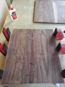

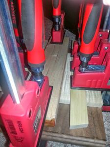

Step 6: Glue Up the Panels
Jointing the boards for a panel glue-up is best done by clamping the two boards together. Any planing out of square will cancel itself out with this method. It is sometimes helpful to put pencil marks before planing to see where the low spots are. I planed slightly more material away in the middle to create a "spring joint". When clamped together the ends clamp tighter to prevent gaps and glue creep.
After the panel is glued up and dried, I placed marks across the panel and used my jack plane and smoothing plane to flatten the panel. The marks once again help identify low spots.
I was deliberate in choosing which boards were to be glued together in the planning phase so the glue line will be hard to spot. I think it was a success.

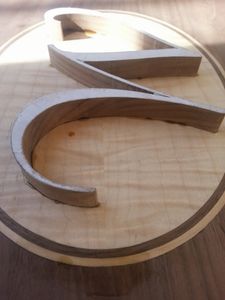

Step 12: Create and Inlay the W
Now it is time to work on the "W". I went online and found a font I liked and printed a large W on printer paper to use as a template. I attached the paper template to a piece of walnut with spray adhesive and used a bandsaw to cut the shape. I made two of them in case one of them broke for some reason. I am sure glad that I made an extra because sure enough one of them broke at the thinnest part. I treated the extra as carefully as possible to prevent it from breaking.
The edges were rough from the bandsaw blade so I clamped it in a vise and used a card scraper, rasp, and sandpaper wrapped around a dowel to smooth the edge. It is important to check it for square too to make sure you don't put too much of a bevel.
Once the W is finished, I used double side tape to temporarily stick it where I want it and traced around the outside with a sharp knife. After marking the edges, I used pencil to darken the knife lines so I could see it well. The same dremel was used with a tiny 1/8" straight bit to remove the waste as close to the line as I dared go with a router. I made the cut in two passes. The rest of the waste was removed using chisels and a drill. This process takes patience and a steady hand.
Step 13: Inlay the W
With the W smooth and the cavity excavated, it is time to glue it into place. This is one step that takes a leap of faith. It is not a good idea to actually dry fit the W into place without any glue, so you better be sure that it will go without too much resistance. If you do dry fit it and it is snug, you will not get it out without some damage. I put a slight chamfer on the bottom corners to help guide it into place.
I used liquid hide glue because the color matches the walnut so any gaps will not look so obvious. I made sure there was plenty of meat on the W so I could flush it down later. I started with a flush cut saw and went around the edges and then finally meeting in the middle. I did not want to ding up the curly maple so I put down a thick piece of paper under the flush cut saw so the teeth would not harm the surface. It may not have been necessary because I ended up doing a fair amount of planing to flush the surface and that would have likely removed any saw damage, but it is a good habit to get into.
Now that everything is flushed and sanded, I inspected for any gaps. Mine had a few that I filled with hide glue and walnut sanding dust. If the gaps are too large, you can actually cut small shims to fill the gaps. After I was satisfied, time for a finish. I used danish oil because nothing brings out figure more than a little oil.
