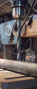

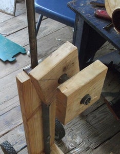

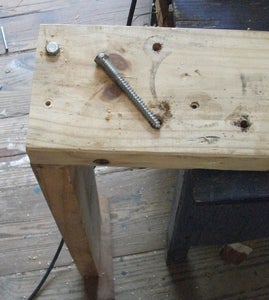

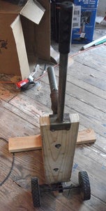

The first thing I made was the frame for the reel.  I used a couple of pieces of 2x6 put together with lag bolts.  For the reel axle I found some 3/4" pipe.  I cut a long piece, around two feet, and another about six inches.  I connected them with an elbow and mounted them on the frame with lag bolts.  The vertical piece gives strength to the axle.  The wheels I found were quite handy.  I mounted them on the bottom of the frame and then screwed a cross piece for stability.  Finally I mounted a handle using a couple of lag bolts.  The handle came from an old generator.

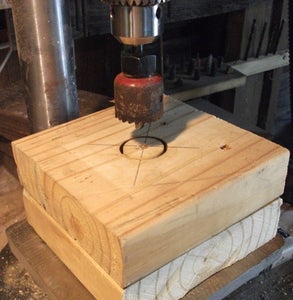

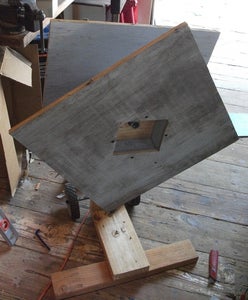

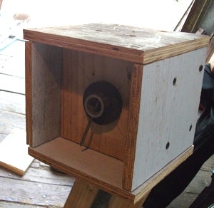

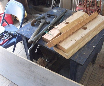

To make the reel I made a hub out of some plywood and a couple of squares of 2x6.  I cut holes in the centers of the 2x6 squares and screwed pieces of plywood to them.  I left an inset on the front of the hub for electrical chord access.  I cut two larger pieces of plywood about 20" square for the sides.  I simply cut a hole in the center of one and mounted it over the hole in the back of the hub.  I cut a square section out of the other side to work over the inset of the hub.  I screwed the sides down, staggering the corners so they would hold the chord on the reel.
To mount the reel on the frame I simply put a couple of rubber washers I had on hand on the axle, slipped the reel on and put two more rubber washers.  I hole through the end of the axle holds a nail that serves as a pin.  I also drilled a hole through the bottom of the pipe elbow and inserted a pin so it would not sway back and forth.

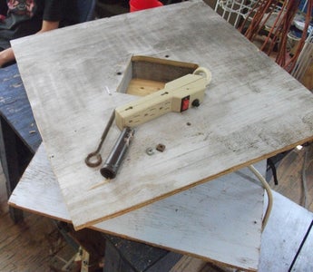

Rather than going to the trouble of wiring in a plug I decided just to install a power strip.  I drilled a hole through the hub for the plug and mounted the strip on the side of the reel.  I made a turn handle from part of an old paint roller, an eye bolt and a couple of nuts. The last thing I did was screw down a hook on the base to route chord to the reel.
