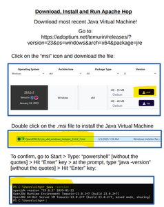

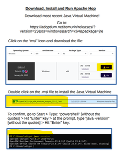

Download, Install and Run Apache Hop:
  1. Download most recent Java Virtual Machine! Go to: https://adoptium.net/temurin/releases/? version=23&os=windows&arch=x64&package=jre
  2. Click on the “msi” icon and download the file
  3. Double click on the .msi file to install the Java Virtual Machine
  4. To confirm, go to Start > Type: “powershell” [without the quotes] > Hit “Enter” key > at the prompt, type “java -version” [without the quotes] > Hit “Enter” key
