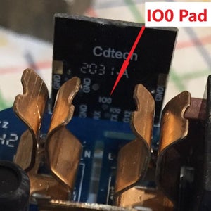

Step 3: Downloading Tasmota Without De-soldering
Question 3: Can we reprogram this Smart Plug without removing the circuit board?
A closer look at the circuit board reveals that there are slots in the board that provide physical separation for the Line terminal, the adjacent Neutral, Ground and low voltage circuits.
Can we use these slots to get to the Tx and Rx terminals of the ESP carrier board?
Yes, with a couple bent Dupont beardboard jumper leads.
Fortunately, the edge of the Smart Plug circuit board has a pad that allows us to provide 3.3V to the board. The shield around the ESP can be used to connect Gnd.
Step 4: Downloading Tasmota - Improved Method
We now have access to the five (5) terminals [3.3V, Gnd, Tx, Rx and IO0] necessary for reprogramming the Smart Plug without de-soldering its circuit board from the Line, Neutral and Ground terminals.

It did take a bit of trial and error to adjust the bent Dupot beardboard leads so that they are connected to the Tx and Rx solder points of the ESP carrier circuit board.
Grounding the IO0 point when powering up the circuit board also takes some practice. An indication that you have grounded to pin is when the onboard led DOES NOT flash continuously. Flashing means it's waiting to be paired, meaning that the firmware is running on the ESP. No flashing means it's awaiting a firmware upload.
With practice, after 3 or 4 attends the Smart Plug is reprogrammed.
