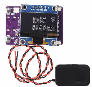

- 1× XiaoZhi AI Voice Dialogue Robot Module

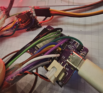

Step: Connect the positive terminals of the two 3 V LED Filament Flow Lights to the 3.3 V pin of the ESP32-S3 AI module. Connect the negative terminals to the ESP32-S3 AI module via AO3400 N‑MOS according to the system wiring diagram at the beginning of this introduction. These two LEDs will be automatically controlled by the AI.
Step 5: Connecting to the AI Brain
Step 1: Connect the XiaoZhi AI Voice Dialogue Robot Module to the ESP32-C3 Super Mini controlling the grill, following the wiring diagram at the beginning of this document. Then, flash the attached program onto the XiaoZhi AI module. This program primarily informs the AI that the hardware includes a grill controller and two glowing horns, allowing the AI to autonomously utilize these components according to its assigned behavior.
Step 2: You may replace the built-in speaker with a larger one according to your needs, as the AI XiaoZhi’s default speaker may be too quiet for outdoor use.
Note: You need to wire directly from the ESP32-S3 module. This step can be challenging, so take care to avoid short circuits.
