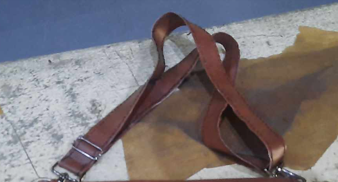

(4) Sling
  • 35" length
  • 1.5" thickness

Step 4: Sewing Sling Parts
(1) Insert snap buckles on both ends of the sling strap.
(2) Loop the sling buckle/sling adjuster in the sling strap.
(3) Sew only one end of the snap buckles, leave the adjustable one unsewed.
(4) Sew the end near the sling buckle to the bottom side of the sling strap.
(5) Attach the D-rings to the sling holders. Sew as well.
(6) Sew the sling holders on each of the bag's sides.
(7) Attach the sling to the bag.
