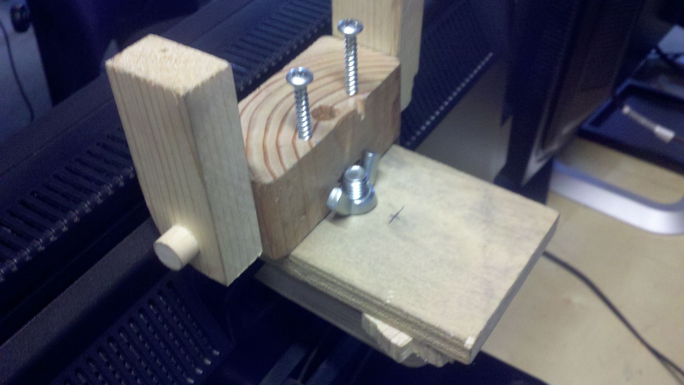

Cut your arms, elbow, hand and shoulder parts. Precision is very important here, and remember to have each pair of holes the same distance apart. Secure each piece tightly, but with some ability to move. I recommend lock washers, or the short two-piece wide head screws I used on the shoulder and elbow. Of critical importance is eliminating any slippage from your joints. If they have any room to move, the angle of your square will not be 90 degrees.
Step 4:
You can cut two pieces for the shoulder, with a larger hole at the top so that you can use them to clamp onto a table or board by fastening them together with a nut and bolt.
