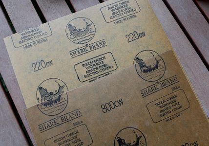

Once, you finish the assembly step, use sandpaper(220cw) to make the surface of wood clean and smooth. Now, clean any dust and use the varnish to give your table that nice shiny look.
leave it for one day to dry. If you want to make it even better you can use sandpaper(800cw) one more time and varnish it again.

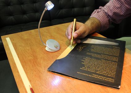

Step 4: Final Product
Here is our final product.
