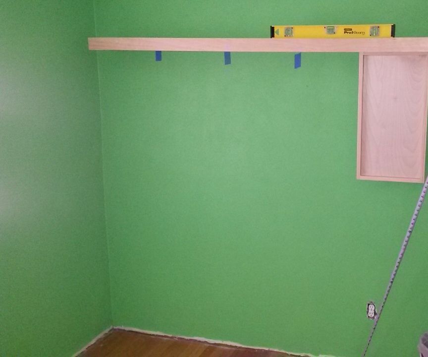

Step 6: Floating Shelf W/ Sliding Tool Board
This shelf was my first Instructable you can see it here: Floating Shelf with Sliding Hanging Organizer. I'll probably update it with more photos showing the finishing and light installation.
It has led lights built into it, finished with water based poly. The sliding mechanism is just a hanger for a bypass closet door.
The tool organizer had to slide, otherwise it would interfere with the tilting drafting table portion of the desk.
