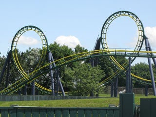

First off I needed to decide the scale, to do this I used a google maps image of the real ride, as well as reference pictures found online. If I'm not recreating a real life roller coaster, I usually draw a couple aerial view sketches to get an idea of the layout. (this idea almost always changes, but it helps to start somewhere)

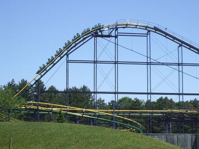

Typically, I find starting with the lift hill a good approach. This will determine the overall height, and will help me guage how much momentum (in the train) I have to work with.

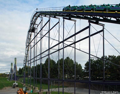

Using real life pictures of the ride, I try and recreate everything from the supports and track into the K'nex equivalent. As a guideline I like to use 7-8 track ties (the black pieces in the pictures) per flexi rod length. Using this many will help keep the track smooth.

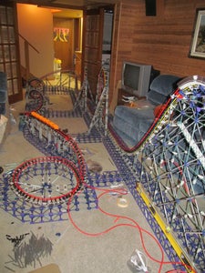

Again using a reference picture I began piecing together the loops, each loop took me approximately 4 hours to get it shaped to my liking.
When I'm building I like to start with a solid base, in this case it was constructed using blue rod boxes, but it can be anything really. A solid base for your roller coaster to sit on is key to keeping the track from moving around while the train is running. If you can keep the track work sturdy, this will help maintain as much speed as possible.
After the base, I tend to construct a 1-2 foot long section of loose track. I then hold this track where I would like it, and build the supports to hold it. I find this way works the best to keep the track smooth as you go.

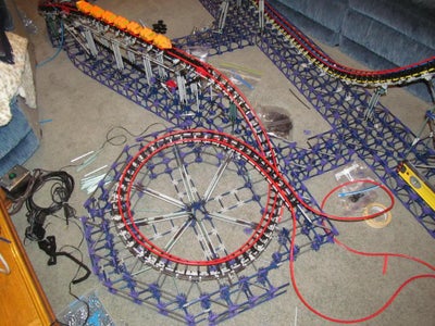

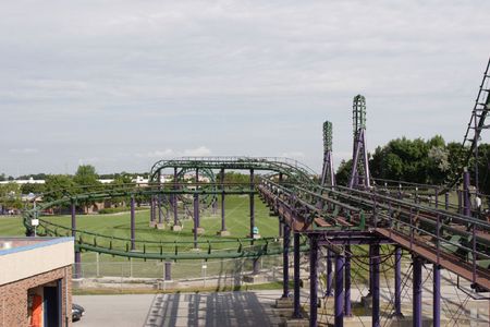

Pretty much just like the loops, I found a reference picture and tried to recreate it to the best of my ability.
As you can see in the third picture, I started laying out where the base was going to sit for the next elements. I kept referencing the google map aerial view in this process.
