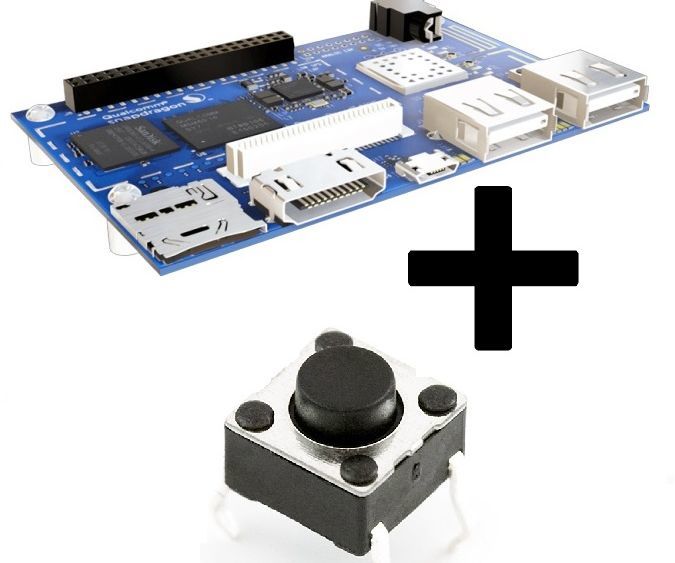

Introduction: DragonBoard 410c and LED (Beginners)
When I started working on a DragonBoard 410c, I had so many difficulties to find simple things tutorials, because the makers assume that you already know how to do the basics, then in this tutorial, I will explain in detail how to connect and use some LEDs with the DragonBoard 410c (DB 410c). This method you can use for others things like DC motors, etc.
