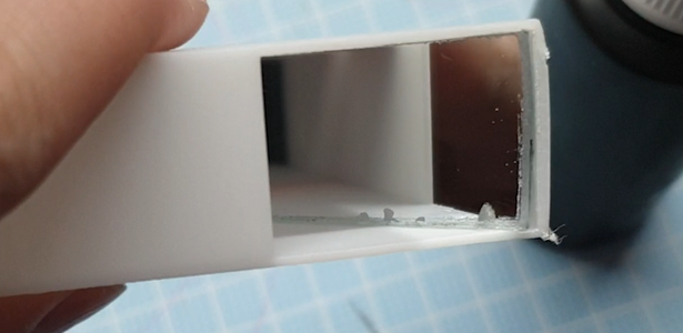

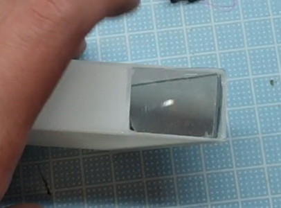

Step 9: Optics
  1. Cut the mirror (4cm x 2cm)
  2. Cut the fresnel lens (2.8cm x 2cm)
  3. Cut the acrylic (4.5cm x 3cm)
  4. Glue the mirror in the scouter
  5. Glue the fresnel lens on the scouter
