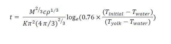

You merely need to raise the temperature of the yolk boundary to around 150-155°F (65-68°C) for a small amount of time. Solving the heat equation for a spherical egg [2], you get the equation in the image above, where K, ρ and c are the effective thermal conductivity, density and specific heat capacity of an egg respectively. For a large egg (M~60g) directly from the fridge (T_initial=4°C) this comes to a fairly even 6 minutes. You could go as long as 6 minutes 30 seconds. Note this will depend on your altitude, which affects the boiling point of water (T_water).
Or… you could also just use a mobile app (my trusty “Egg Timer Free” for Android by Mobication has always given perfect results) and set to “largely set/soft solid”.

[5] Interestingly enough, this is also the heat equation, if we consider temperature instead of concentration! This was the exact law used to determine the cooking time for the egg above in Step 1. Physics is wild.
