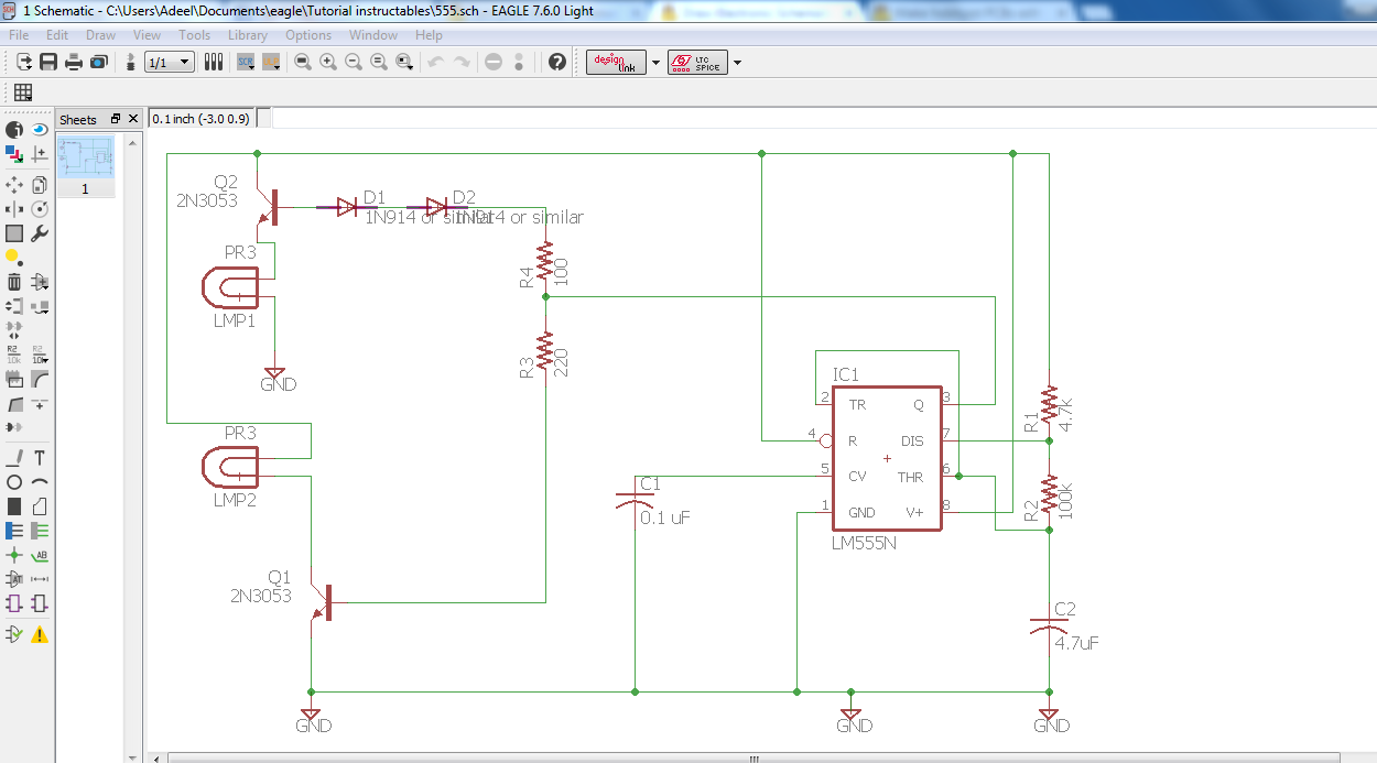

Step 13: Start Making Connections
You might think that you'd use the "wire" command to make connections in your circuit.
However, a wire in EAGLE is just a line; to properly make actual electrical connections, you need to use the "net" command. Nets will automatically form junctions when terminated on pins or other nets; I don't think wires are so nice.
Once you've clicked the NET button, your mouse pointer becomes your drawing tool. Click on a pin (or anywhere, actually), move your mouse somewhere else and you'll see a line. The actual route that the line takes is controlled by the "wire bend" setting for the line, which you can control with your right mouse button. Schematic designers tend to like nice straight lines with right angles.
So first I draw a nice V+ line sort of over the top of the schematic, starting at the top of R1. Next, similar for a ground wire (you don't actually need to connect the GND symbols, they're "magic" in they name the net that connects to them, and all nets of the same name are connected whether you can see lines between them or not.) Then I go wild and connect all the other pins appropriately, either to other pins to to the existing nets. Junctions (big solid dots) should get insterted

Step 16: Do Rule Check!
The button shown does an electrical rule check. It will check whether the pins designated outputs are connected to inputs, whether there are obvious missing junctions, and stuff like that. When we run it on our schematics so far, we get a warning that the power pin named V+ on the 555 is connected to a net that DOESN'T have the name V+. We could fix that with the name command, or just leave it as is.
In general, you don't have to FIX every warning that shows up in a rule check, but you should understand what the complaint is, and have a good justification WHY you don't need to fix it.
