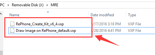

Step 7: COPY VXP FILE
After successfully built the application, you should
1. find the vxp file in the location of the project : eclipse\Workspace\Draw Image on RePhone\ARM\Draw Image on RePhone_default.vxp
2. Copy it to your RePhone's storage mode, right in root location, a folder called【MRE】
3. Change the content of 【autostart.txt】to:
