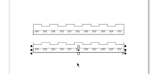

Plus, you'll have a design for a pair of handy test pieces to help you figure out how to size your laser-cut boxes so they snap together just the way you want! (To make the combs, continue through Exporting Inventor Files to CorelDraw [forthcoming], then cut them on your handy local laser.)

Continue drawing teeth and notches of slightly increasing sizes. Whee!
I made all my teeth larger than any of the notches. Even a laser removes a little bit of material, so the teeth will need to be larger than the gaps in order to fit snugly.

Step 6: Make an Inverse Comb
Now say we want to make some notches and teeth of different sizes. We can't mirror the whole comb or we'll have the same thing. Instead of redrawing the comb, we can invert just the "teeth" edge and draw a new comb body.
1. Select "Mirror", then click Select.
2. Select the teeth-and-notches part of the comb.
3. Then click Mirror Line, and click on the bottom line segment of the comb.
4. Click Apply, then Done.
5-8. Draw in the rest of the comb body by anchoring line segments to the edges of the notches and drawing the flat edge of the comb.
