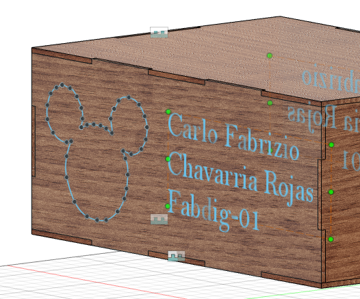

1.- For our box to have our design, we will select Face A and select a face and right click to "create sketch" (IMG1) . Then we insert a canvas and add our image and adjust it to the desired (IMG2) .
2.- With the "line" or "spline" tool we will border the entire edge until we reach the other side and finally connect (IMG3) and then fix.
3.- Now with the "text" tool in create, we will add a small text that can change according to what you want (IMG4 and IMG5) . Before finishing we select the text with right click and We select explode text (IMG6) .
4.- Finally it would be ready to Arm (IMG7) .

1.- First we must save with the desired name (IMG1) . (The angles are as follows (IMG1.2 and IMG1.3) )
2.- The second thing we will do is drag our Face C (IMG2), this object must go to the shortest side that is to say the right or the left , we move it to the center now with the upper wheel (IMG3) and move it to 90deg (IMG3.2) , followed by dragging Face B (IMG4) and it will be placed in the center (IMG5) and with the circle of the half we move it to a left or right side (IMG6) .
3.-Now with the B and with the Angle Y (IMG7) and we move it to 90deg (IMG7.2) . Now with the "Join" tool we will arm it by selecting the 60mm line, selecting the back line (IMG8) and then on Face C on the 60mm line (IMG8.2), we repeat this for the other side (IMG9) .
4.- Now we drag Face A (IMG10) and with the circle of the middle (IMG11) we move it to a side whereby the letters are correct (IMG11.2) . To join it we will use the "join" tool again using the 50mm middle line of face A (IMG12) using the line facing us and on face C the 50mm middle line using the line that looks up (IMG12.2)
5.- For the other side the same will be done but when adjusting the text, we move to a part in which no It is so close (IMG13) , now grabbing the Y angle (IMG14) we move it to 180deg (IMG14.2) , after this We will put together in the same way as the other part (IMG 15 and IMG15.2) . And now only the top part would be missing (IMG16) .
6.- We are in the final part to complete the drawer, to finish we add Face C again (IMG17) and we take it up (IMG19), now with the angle X (IMG19) we move it up to 90deg (IMG19.2) . To join it we can simply take any place where it is in the middle and we will always use from Face C the line of the middle of the 4 sides that faces down (IMG20) and to join it with the part from outside the face that we use (IMG20.2) .
