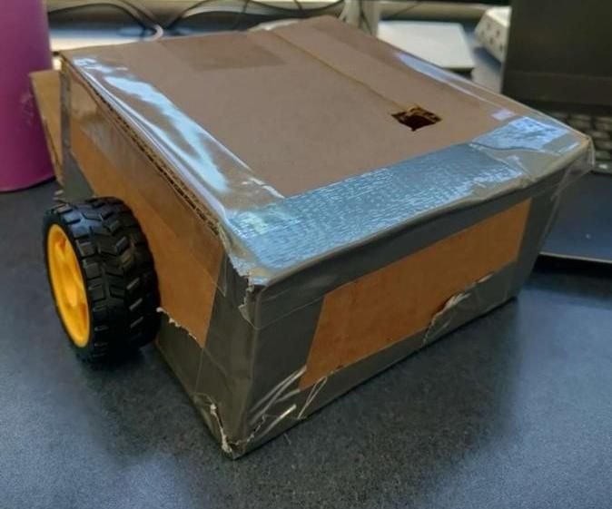

Introduction: Drawing Bot - Explaining the Code

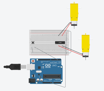

My team and I created to help break down the code

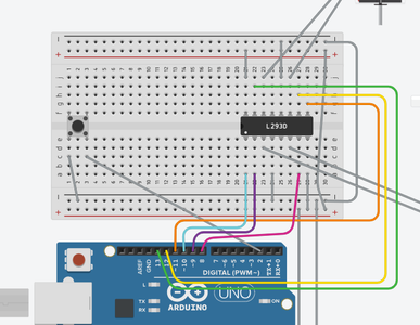

Tools from kit;
·       1 Arduino Uno
·       1 Small Breadboard
·       1 Motor Driver
·       1 Button
·       1 Medium Cardboard Box
·       1 Marker
·       1 Large Sheet of Paper
·       2 Hobby Gearmotors
·       2 Wheels
·       15 Jumper Wires
·       1 Battery Pack
·       4 AA Batteries
Link to all of the tools : SparkFun Inventor's Kit for Arduino Uno - v4.1 - KIT-15631 - SparkFun Electronics

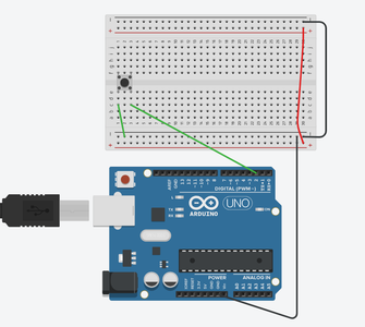

Step 1: Code Step 1 and Writing Setup 1
First step name what the project will be
// Drawing Bot propjet
We than create an integer value for the button and assign it a value of 2 on the Arduino Board
Int button =2;
Int buttonval;
Void set up ()
// set up button
pinMode (button, INPUT_PULLUP);
// helps detect when button is pushed
serial.begin(9600);

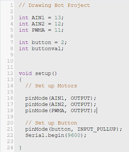

Step 2: Code Step 2 and Writing Setup 2
int AIN1 = 13;
int AIN2 = 12;
int PWMA = 11;
// These lines declare variables named AIN1, AIN2, and PWMA, assigning them values 13, 12, and 11 respectively. These values represent the pin numbers on the Arduino board that are connected to control the first motor.
// In the void set up
// Set up Motors
 pinMode(AIN1, OUTPUT);
// This line configures pin AIN1 (which is connected to the first motor) as an output, indicating that it will be used to send signals to control the motor.
 pinMode(AIN2, OUTPUT);
// Similarly, this line configures pin AIN2 (another pin for the first motor) as an output.
 pinMode(PWMA, OUTPUT);
// This line configures pin PWMA (the PWM pin for controlling the speed of the first motor) as an output
 // Set up Button
 pinMode(button, INPUT_PULLUP);
//This line configures the button pin as an input with a pull-up resistor enabled. It means that when the button is not pressed, the pin will be in a HIGH state, and when the button is pressed, the pin will be in a LOW state.
 Serial.begin(9600);
// This line initializes serial communication with the computer at a baud rate of 9600 bits per second. This allows us to send data from the Arduino to the computer for debugging or other purposes.

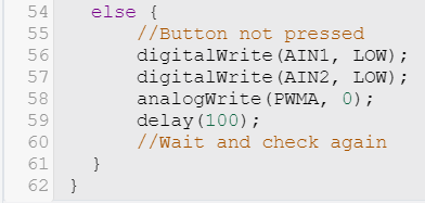

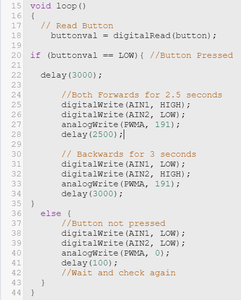

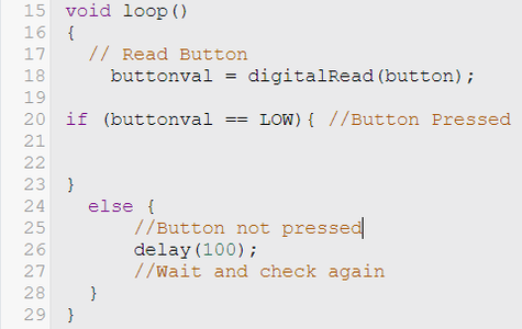

Step 3: Code Loop Setup 1
void loop() //* will run as long as the board is on
 // Create on/off code
// This part of the code checks the button state. If the button Is pressed, some action will take place. If the button Is not pressed it will wait briefly and then check the state again.
   buttonval = digitalRead(button); //*Reads the digital state of button
if (buttonval == LOW){ //Button Pressed
 else {
     //Button not pressed
delay(100);
     //Wait and check again
Step 4: Code Loop Setup 2
void loop()
// This checks if the button is pressed or not and stores that information in a variable called buttonval
 delay(3000); //Delay for three seconds for safety
     // Both Forwards for 2.5 seconds, This sends a signal to the motor to spin in one direction.
     digitalWrite(AIN1, HIGH);
     digitalWrite(AIN2, LOW);  // This sends another signal to the motor to spin in the same direction.
     analogWrite(PWMA, 191);  // This controls the speed of the motor. A higher number means faster speed.
  // Backwards for 3 seconds
     digitalWrite(AIN1, LOW); // This sends a signal to the motor to spin in the opposite direction.
     digitalWrite(AIN2, HIGH); // This sends a signal to the motor to spin in the opposite direction.
 else {
   //Button not pressed the motors AIN1 and AINS are set low
     digitalWrite(AIN1, LOW); // This sends a signal to the motor to stop spinning.
     digitalWrite(AIN2, LOW); // This sends a signal to the motor to stop spinning.
     analogWrite(PWMA, 0); // This stops the motor completely by setting its speed to 0.

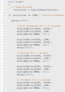

Step 5: Loop Step 3 Part 1
void loop()
     //Both Forwards for 2.5 seconds
// The first motor (AIN1 and AIN2) moves forward.
Both motors move at a medium speed (PWM value of 191).
     // The second motor (BIN1 and BIN2) also moves forward.
     digitalWrite(BIN1, LOW);
     digitalWrite(BIN2, HIGH);
     analogWrite(PWMB, 191);
     delay(2500);
     //Turning for 1 second
// The first motor continues moving forward
     // The second motor now moves backward, causing the robot to turn
     digitalWrite(BIN1, HIGH);
     digitalWrite(BIN2, LOW);
     delay(1000);
     // Forward for 4 seconds, Both motors move forward again
     delay(4000);
     //Turning for 2 seconds
// The first motor keeps moving forward
  // The second motor moves backward again to make the robot turn more.
     delay(2000);
// The first motor now moves backward.
The second motor still moves backward
Step 6: Loop Step 3 Part 2
else {
   //Button not pressed we stop the motors
delay(100);
     //Wait and check again This pauses the program for 0.1 seconds (100 milliseconds).

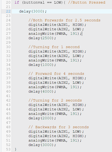

Step 7: Loop Final Part 1
void loop()
   delay(2500);
   delay(1000);

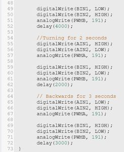

Step 8: Code Loop Final Part 2
   delay(4000);
   delay(2000);
   delay(3000);

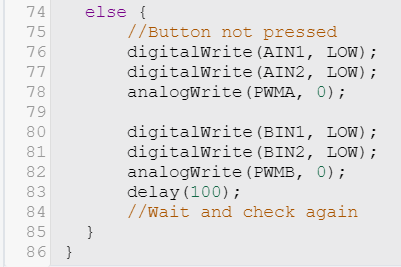

Step 9: Code Loop Final Part 3
else {
   analogWrite(PWMB, 0);
   delay(100);

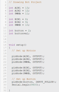

Step 10: Final Code Set Up
int AIN1 = 13;
int AIN2 = 12;
int PWMA = 11;
int BIN1 = 8;
int BIN2 = 9;
int PWMB = 10;
//We than create an integer value for the button and assign it a value of 2
int button = 2;
int buttonval;
void setup()
 // Set up Motors
 pinMode(BIN1, OUTPUT);
 pinMode(BIN2, OUTPUT);
 pinMode(PWMB, OUTPUT);
 // Set up Button
 // Helps detect when button is pushed
 Serial.begin(9600);
