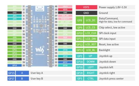

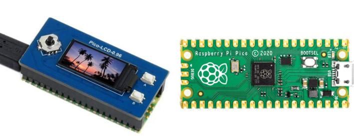

The Waveshare 0.96" LCD Display Module for Raspberry Pi Pico (160×80 pixels) has sockets corresponding to the pins on the Pico and the two can be gently pressed together to connect them. Do not press on the screen, just the circuit board, and make sure that you connect them the right way round with the joystick at the USB socket end of the Pico. The joystick and buttons will provide simple inputs for our projects.
As is usual for displays the advertisement shows a colourful photographic image. This is possible, as demonstrated in the picture, and I will provide a link about how to do it at the end.

Waveshare supply an example program with the screen driver included rather than as a separate library. (I quite like this method as you do not have to keep adding and removing libraries as you change peripherals.) I've provided a version of it below with a few additions.
It shows lines, text and how to access the joystick and buttons. The screen driver is the most important part and must be included in all programs using the screen.

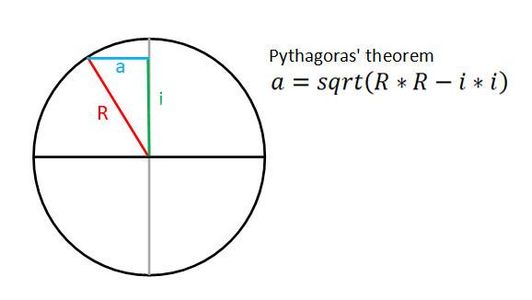

If we draw a radius in a circle and then draw in vertical and horizontal lines to form a right angled triangle as shown in the diagram we can use the theorem of Pythagoras to calculate the length of side a for every value of i. If we then draw horizontal lines of length a in both directions from the vertical diameter it will touch both sides of the circle at its circumference. Drawing a series of such lines, for every pixel line, will fill in the circle.
def circle(x,y,r,c):
  lcd.hline(x-r,y,r*2,c)
  for i in range(1,r):
    a = int(math.sqrt(r*r-i*i)) # Pythagoras!
    lcd.hline(x-a,y+i,a*2,c) # Lower half
    lcd.hline(x-a,y-i,a*2,c) # Upper half
    lcd.display()
    utime.sleep(0.1)

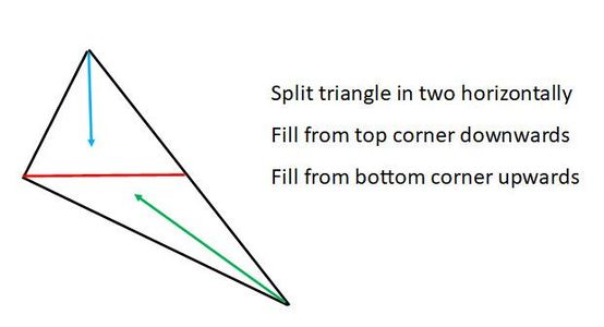

Drawing a filled triangle is much more difficult. The technique has been written up here:
http://www.sunshine2k.de/coding/java/TriangleRasterization/TriangleRasterization.html
The method is similar to that used with filled circles - we draw horizontal lines between the edges to fill in the space.
This is easier if we have a triangle with either a horizontal top edge or horizontal bottom edge. If we do not have a horizontal edge we split the original triangle into two triangles with a horizontal line and then draw the triangles separately. This all sounds quite easy but it involves a great deal of mathematics. Thankfully, you do need to understand the maths to use it. I've made a simple command to call the rather complicated routine.
c = colour(0,255,0)
tri_filled(x1,y1,x2,y2,x3,y3,c)
lcd.display()
The full code is in the demo program below and a video of the program running is on the next step.
