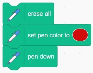

Step 2: Select Pen Color
Now, clear the screen and choose your favorite color for the pen. Figures are drawn on the stage when sprite moves only when pen down block is activated.
