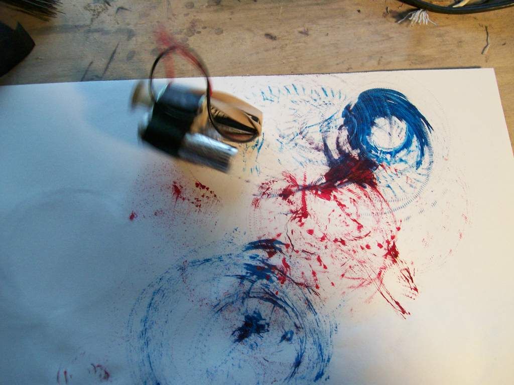

Step 4: The Drawings
Once you have everything in place, plug in your drawing machine and marvel at the wonder of the artistic process. The machine can be clamped down to a table, which will restrict the motion of the machine, or it can be let to run free around your shop. Make sure you have adequate extension cord allowance if you opt for the latter, and it's a good idea to check on the little bugger every so often. Mine tended to wedge itself quite firmly under tables if I wasn't careful.
The possibilities are endless. I've since modified this machine to accomodate 20 by 30 inch paper, and I've also made teeny tiny drawings. Some other ideas include using a sharp, steel stylus on copper plate with an acid resist applied. The marks made by the machine would then be etched in an acid bath. Monoprints anyone? Or the machine itself could be used AS the stylus to make super huge drawings.
Here are but a few of the drawings I made using this machine.
