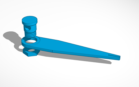

Here's a quick and easy way, with a little 3D printing, to turn a drawing pencil into a compass.
The Capricious Compass is comprised of five parts: a leg, nut, bolt, pencil, and a straight pin. Assembly should take about 10 - 15 minutes.
  • 3D print your compass parts on a fine setting (support material not needed)
  • Warm the bolt with a torch or lighter a bit to soften the threads
  • Screw the bolt on carefully and run the full length of the threads
  • Remove the nut, insert the bolt into the compass leg, and replace the nut
  • Hot-glue a straight pin into the tip of the compass leg - be careful, it's sharp!
  • Insert your pencil into the bolt and adjust height to taste
