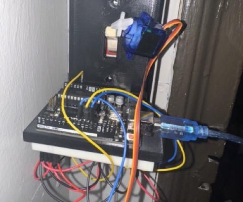

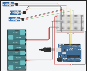

Step 3: Build Robot: Wiring
Wire the Arduino board as shown in the TinkerCad diagram.
Pin 9 is the small servo. This servo is powered directly by the board
Pin 10 is the 25kg servo attached to the arm. This servo is powered by one of the battery packs.
Pin 11 is the 25kg servo attached to the base. This servo is powered by one of the battery packs.

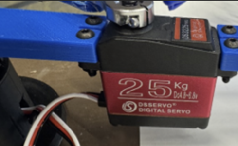

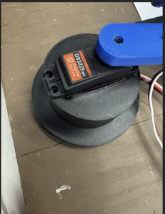

Step 1: Insert one 25 kg servo motor into the 3D printed part “DrawingRobot-ArmBase”. To secure it in place, M2/M3 screws will be used.
Step 2: Attach the 3D printed part “DrawingRobot-ServoHorn1” to the base servo motor using M2/M3 screws.
Step 3: Attach the one end of the second 25 kg servo to the other end of “DrawingRobot-ServoHorn1” using M2/M3 screws.

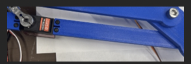

Step 4: Attach “DrawingRobot-LowerLinkage” to the other end of the motor in step 3.
Step 5: attach “DrawingRobot-ServoHorn2” to the top of the servo in step 3.

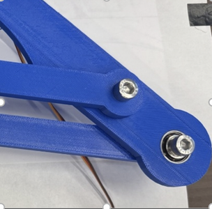

Step 6: Using a bearing and an M6/M8 bolt, attach the “DrawingRobot-ServoHorn2” and the “DrawingRobot-UpperLinkage”. The “DrawingRobot-UpperLinkage” should rest on top of “DrawingRobot-ServoHorn2”.
Step 7: Using one bearing and two bolts, attach “DrawingRobot-MainArm” to both the “DrawingRobot-UpperLinkage and “DrawingRobot-LowerLinkage”. The “DrawingRobot-UpperLinkage” should rest on top, using a nut to keep it in place, while the “DrawingRobot-LowerLinkage” should be fastened under the “DrawingRobot-MainArm”.
Step 8: Attach the 9 g servo to the end of the “DrawingRobot-MainArm”. Fasten a pen to said servo using zipties.
