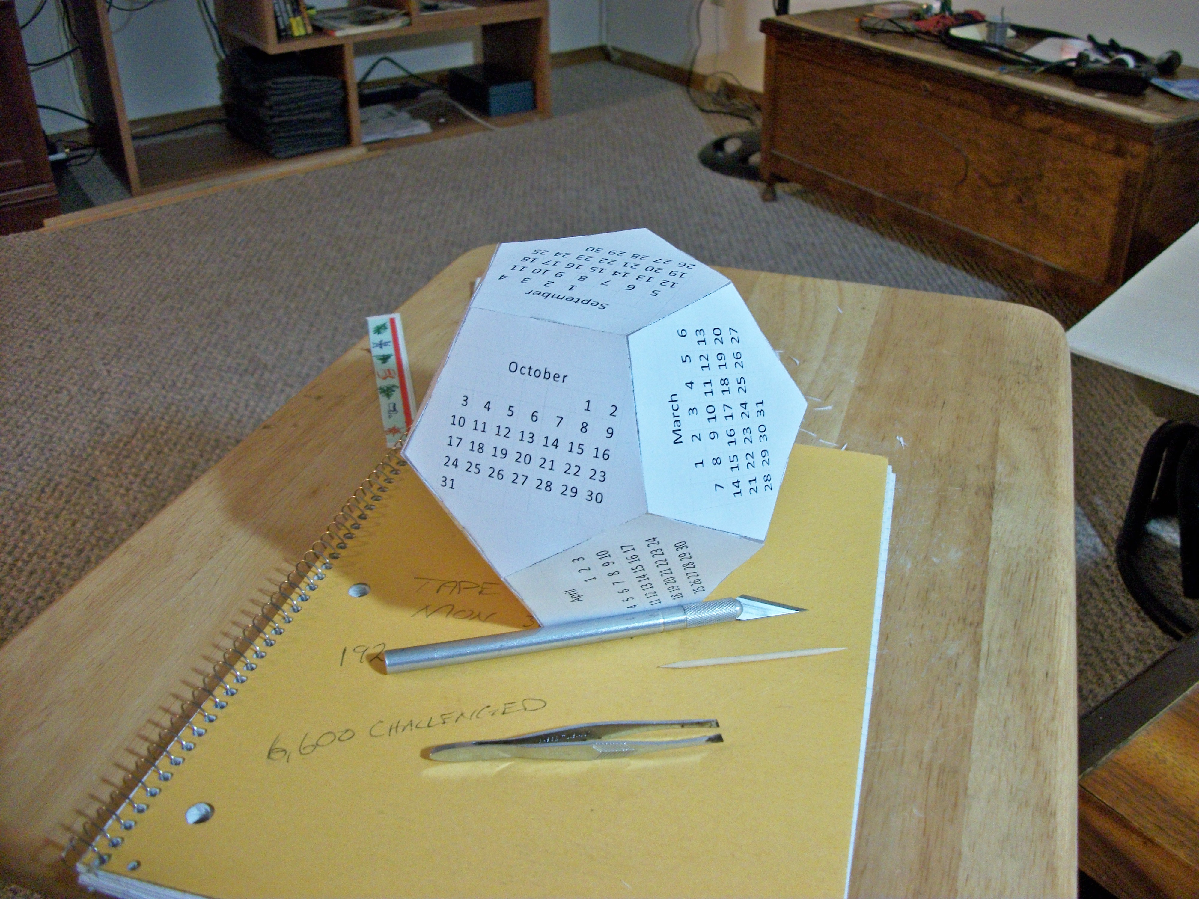

Introduction: Drawing a Pentagon
This is a companion to the Dodecahedron Calendar project. Here I demonstrate how to draw a perfect pentagon. You will need a ruler and a compass.
