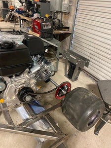

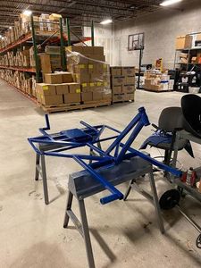

Step 2: Assembling the Rear Frame
After you have your initial design and tubing ordered, it’s time to start welding the rear part of the frame. I began by cutting 6ft pieces of square tubing and notching them up to the round tubing I had already bent to shape using a pipe bender. I then followed my design and cut pieces accordingly, tacking them in with my welder. After everything lined up I fully welded the rear frame in place. I then began to drill holes for the rear pillow blocks and axle assembly.
Start to put together the rear axle assembly by mounting the sprocket, pillow blocks, rear brake and wheels to the axle. After you have the rear axle assembled and mounted, mount the engine to the rear frame with clutch attached. Align rear sprocket and clutch sprocket and then install the chain.

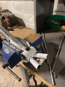

Step 3: Chopping Up the BMX
Start by cutting the top tube, seat tube, and chainstay from your BMX bike. All that you want left is the down tube and the front fork/wheel assembly. You want to weld the bottom bracket of the BMX to the rear part of your frame. I mocked up the rear frame with the BMX front before I began welding. You may also want to strip the paint from your BMX if you plan on giving the entire trike a new coat of paint when finished. I used a polish wheel to strip the paint off, which may have not been the best idea because it didn't leave a completely smooth surface. For a smooth surface I recommend using a paint stripper.
Step 4: Combining BMX Front With Rear Frame
After I mocked up the frame and got the front and rear positioned properly I welded them together. Take your time with this as this is a major stress point for the chassis. For extra support I also welded in a custom top tube to take some of the load, which is optional.

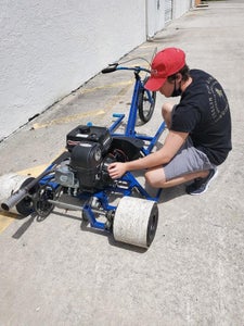

Step 5: Test Ride!
After you have assembled the entire chassis make sure everything is tight before you ride. Give it a few test runs and fix problems that come up.

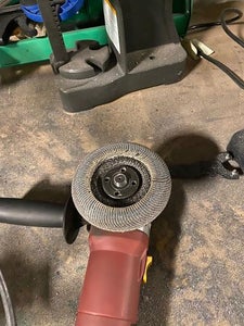

Before you paint or powder coat your chassis make sure to sand down any rust that has developed on the bare metal, as it will be hard for paint to adhere to your frame if there is too much rust. I recommend using a polish/sanding disk on an angle grinder.
