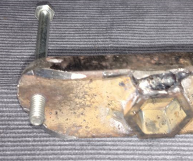

First I prepared for welding by beveling the corners. Weld them together. I know I am not the best welder,but This was a good practice project. I only have an arc welder. First I welded 2 that were 3 spikes long; 4 that were 2 long and 4 blocks 2 spikes wide. I ground all my welds flat then I welded the the the long strips together into blocks of 3 and welded the jaws into blocks of 4. then I ground again. The threaded rod in this picture was just to help me visualize it at this point.

I drilled a hole slightly bigger than the tenon on the screw in the correct location. I drilled and tapped a hole about an inch from this one to bolt the retaining clip to. I was unable to make the retaining clip retract the moveable jaw on my vice. I blame my poor tolerances and flatness issues. I added a spacer made out of railroad spike to the bottom of the moveable jaw. after welding and grinding this I drilled and tapped 2 holes into it. I also made a bottom plate to bolt on. I started by tightening these bolts too tight, and the jaw didn't slide freely. After loosening them the moveable jaw slid freely on the ways.
